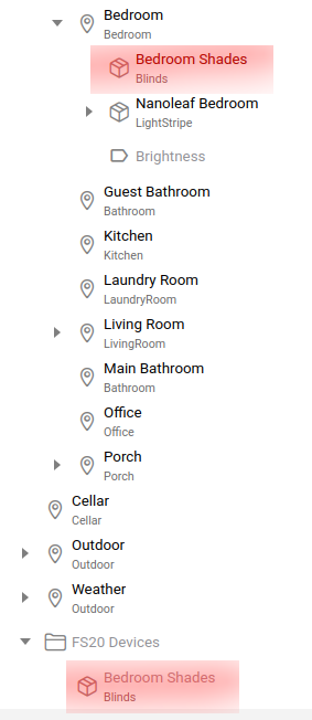

@JustinG , thanks a lot for your answer! I didn’t know that I have to go through the Items view rather than the Model view.
@rlkoshak I have now separated the semantic and functional groups. This is how my model looks (showing non-semantic items):

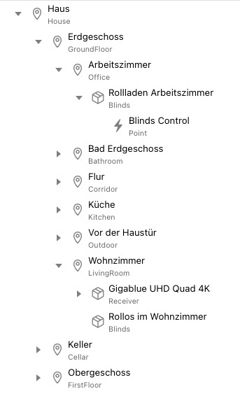

I’m currently rebuilding my entire openHAB setup, coming from v2.*, trying to stick as close as possible to the OH3 tutorial and the semantic approach.
If I understand it correctly, the vertical groups are derived automatically depending on the location and the relationships between the locations. So it would be sufficient for HABot, to have all rollershutter’s blind controls in their respective locations (eg. house → first floor → living room → rollershutter, etc etc), and ask something like “close all rollershutters in the house”, since all floors are childs of the house, all rooms are childs of the floor and so on. It will figure it out because of the semantic model, right?
To accomplish the same via Alexa though, I need an seperate group of all rollershutter’s blind controls where I can add the metadata. How do I do it without interfering with the semantic model?
Even if I remove the semantic properties, like location and category, from the item, it still interfers with the model @JustinG pointed out.
For example I have the Metadata for Alexa on these kind of groups for the rollershutters, with a members base type set to rollershutters:
The same goes for the “Rollos im Wohnzimmer” Equipment, where I had all of the blind controls from all the rollershutters in the living room. That works fine and I can control the blind controls via Alexa.
But then it struck me… To stay true to the model, wouldn’t I need one equipment for every single rollershutter, so I can have all channels in it which the rollershutter z-wave thing offers? And then an enclosing equipment on top of it?
Ideally I would only have the single rollershutter equipments with all the channels in it in the model and several “functional” groups which are completely independent of it, to control those via Alexa Metadata.
But how?! I couldn’t figure it out so far… Thanks for the help :slight_smile:

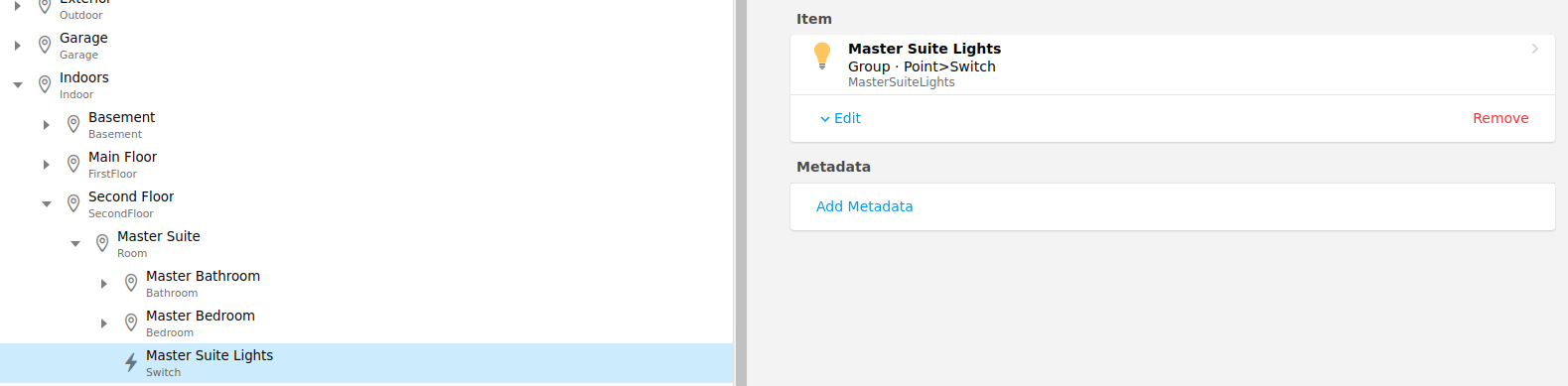

Here’s and example where I’ve done something similar with the lights in my master bedroom suite because I have some rules that function based on the states of light across these two related spaces.
There is no reason this group has to be a part of the model, it doesn’t add any functionality to the model, but it also doesn’t interfere with any of the model functions (* Can’t say for habbot, I almost never use it). It just makes sense to me personally so that’s what I’ve done.

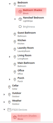

The problem that I have is, that if I have a second group or more groups, in which the Points are members of, they’ll only appear in one group in the semantic model‘s tree representation. Is this only a graphical problem or a structural one?

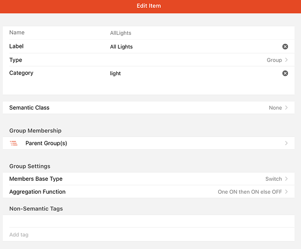

Go to the Items settings, create an Item and make it a Group type Item, presumable with a type and aggregation function as well. Refrain from giving it any semantic tags.
The model is a way to view and organize some of your Items. It is not intended to be comprehensive. You can’t do everything Item related from there.
A little of both. Anything that uses the model is going to assume that a Point Item will only be a direct member of one semantically tagged Group. Period. That means, in the Model view the assumption is that any Item can only appear once in the tree. Therefore it’s a UI problem because it won’t show any Items in the model more than once. But it’s also a structural problem because anything that currently uses the model or will use the model in the future also has the same assumption. Since a sensor can’t be in two physical places at once, it can’t be a part of two Equipment or two Locations at once either. It can only show up in the model in one place.

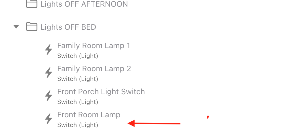

But, this limitation does not apply to stuff that is outside the model. Your Item can appear in as many other Groups as you need. For example,

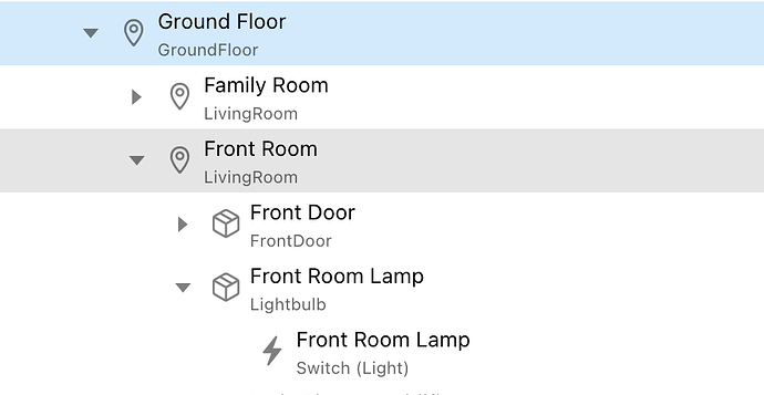

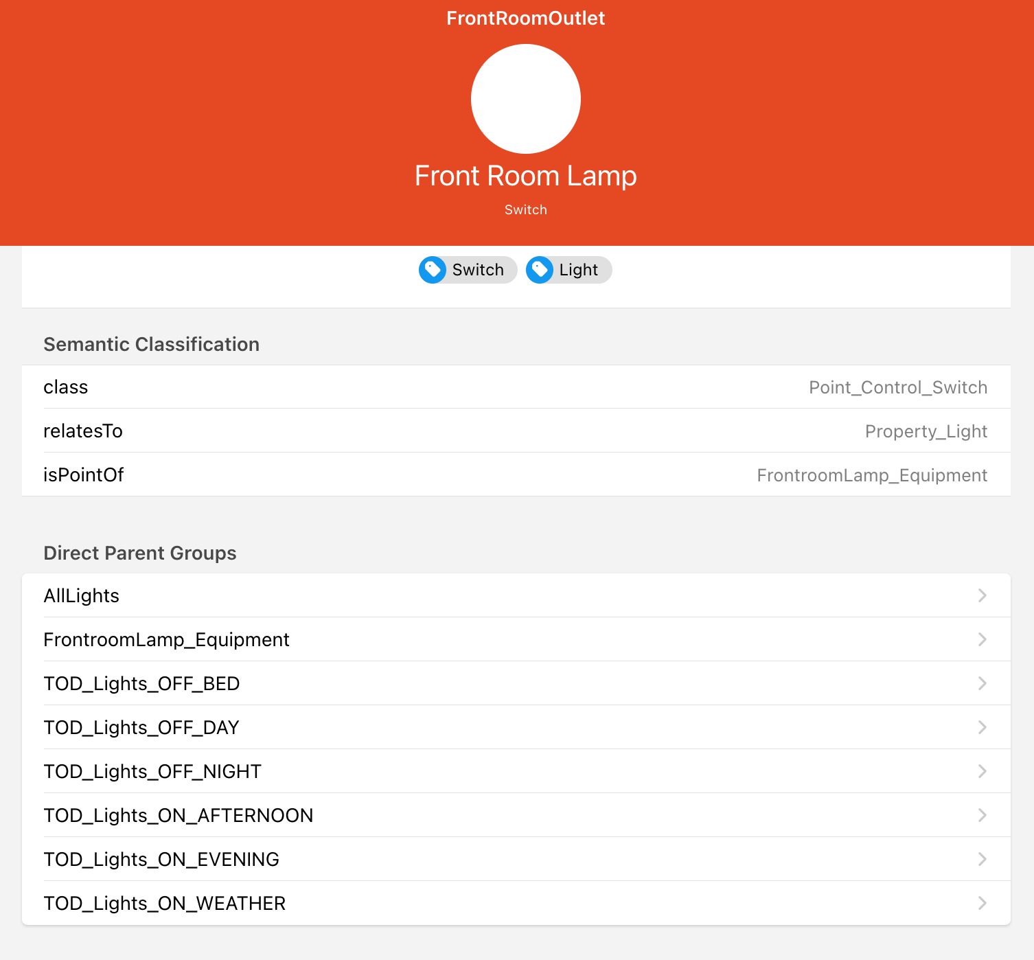

This is a smart outlet that controls a lamp. Notice it is semantically tagged as a Switch/Light Point Item and it is a member of the FrontroomLamp_Equipment Equipment which is tagged with the Equipment Lightbulb tag.
But you will also see it’s a member of seven other Groups. But none of those Groups are semantically tagged.

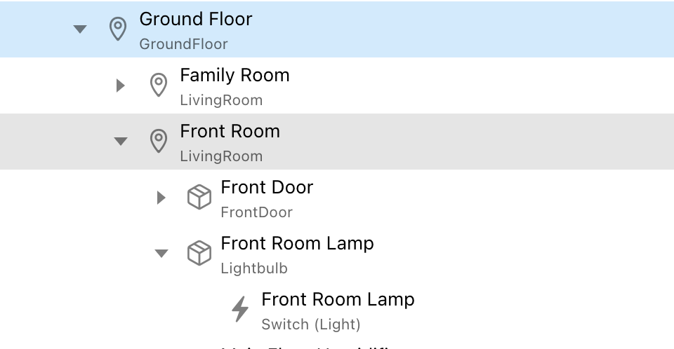

In the model view everything shows up as expected. It only appears once in the actual Model (since that is all that is allowed):
If I try top add the Item to another Group that has an Equipment or Location tag though the Switch will only appear in one of them because the assumption is that a Point can’t physically be a part of more than one Equipment or Location at the same time.
