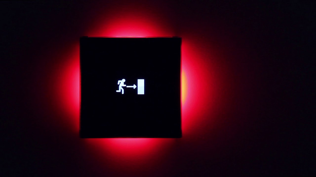

To at least me it remained unclear what you mean by a “panel” and what you want to use it for.
You can attach any IP device (smartphone, tablet, PC). They present a user with a full UI such as HABpanel or BasicUI and will talk to your main OH server only. You can have as many of them as you want. Securing your network remains your job. Firewalling, VLANs, …
There’s also “panels” such as in the picture above that are part of a subsystem like KNX, ZWave or ZigBee (and more proprietary ones). In these cases you need a gateway into these technologies which can be a standalone IP device or a HW extension (USB stick et al) of your server. The gateway connects to devices of the same subsystem using wires (KNX) or non-WiFi/IP radio (ZWave, ZigBee).
But of course these panels don’t have full UI capabilities. Eventually they can only control devices of the subsystem as that’s what they’re built to do - using them as a generic input for OH is sort of ‘misuse’ albeit popular among OH users.
So the answer depends on the type of panel and what you want to do with them.
