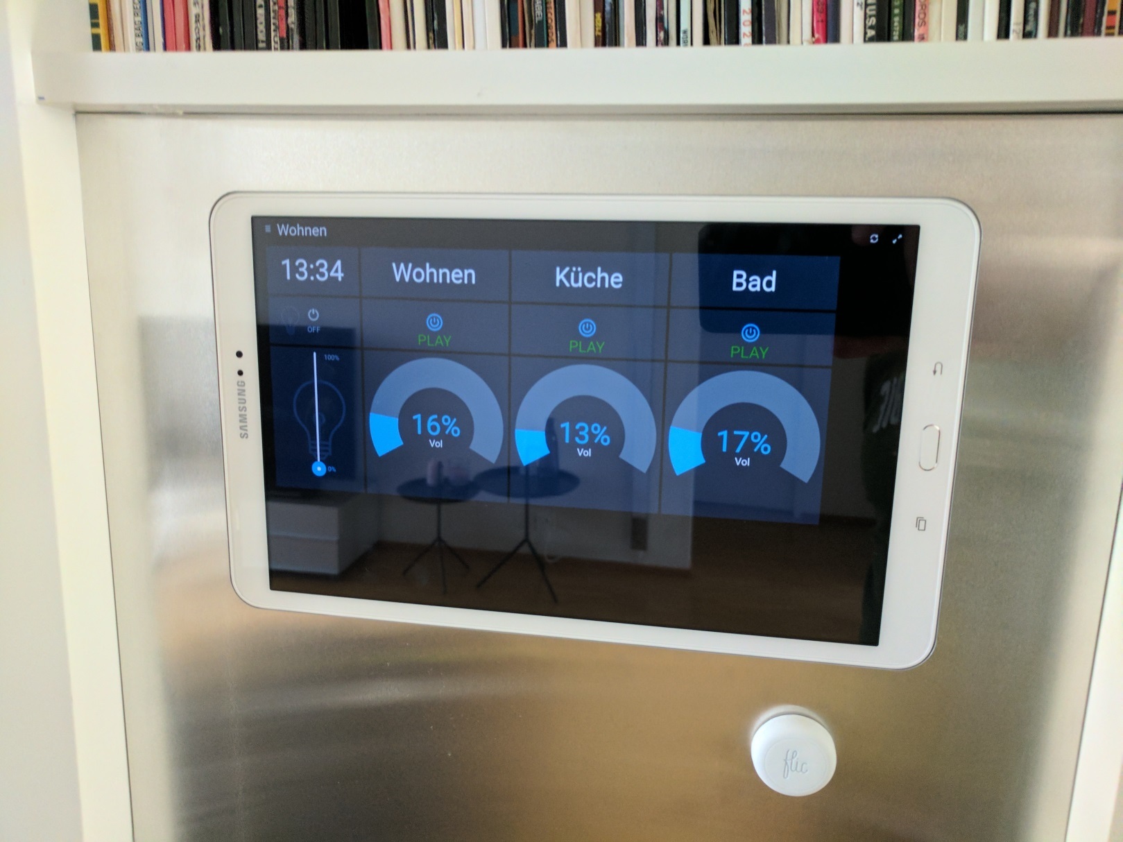

I use a “framed” Samsung Tab A (2016) Android tablet with “Fully Kiosk Browser Lockdown” (https://goo.gl/8DU5N0). This setup works great without any issues.

@tailor I like your solution. What are u doing with these “Play”-Buttions in every room?
I think this is for multiroom audio?

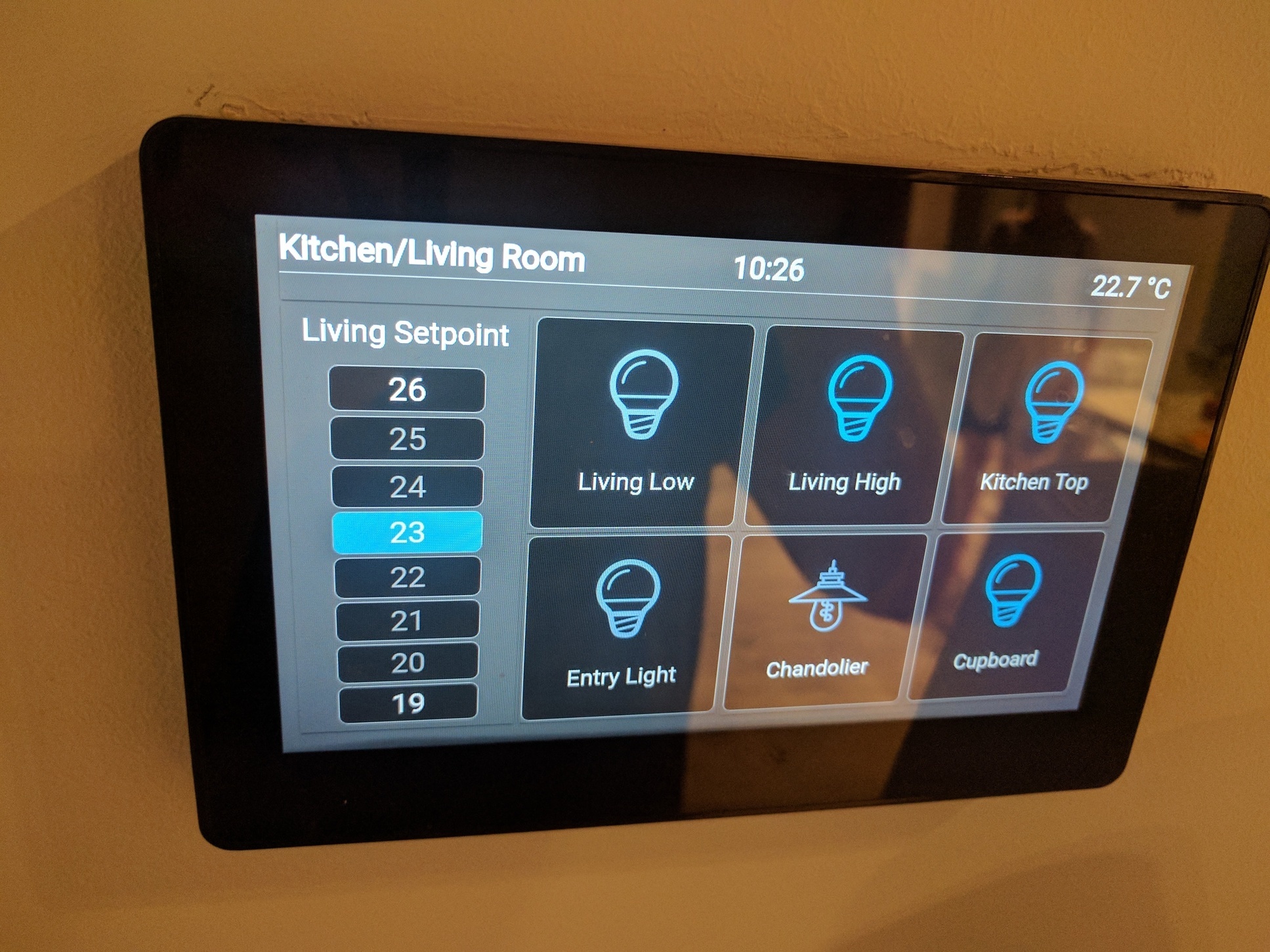

I use SIBOs 896 for display of the habpanels.
They do have POE and flush mouting cage.
