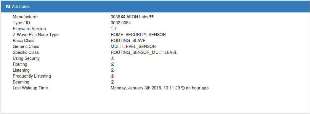

I upgraded the firmware to v1.11 however according to habmin it’s showing 1.7 so not sure if I understand why.

The M6 appears to be working fine with the 1.11 update in OH apart from not being able to see the new option.
I’d need to check to make sure that it updates this - as it’s not something that normally changes, maybe the binding doesn’t update this. If you delete the thing and add it back (no need to exclude/include etc) then it will definately update.
Parameter 81 is not in V1.7 which is what the binding thinks the device is - that’s why it’s not showing the option.

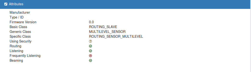

Ok, that’s more like what I would have expected. What do the attributes now show?
Hi
Showing as below
Regards
Ok, that’s a bit sad if it’s not providing the firmware version. Time for that debug log I guess :wink:

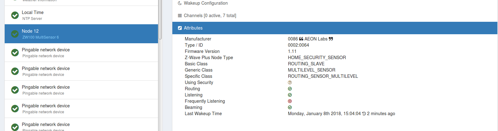

Was looking for at the node xml files and noticed I have none for node 11 but the following file was created during one of my attempts to add the M6 and it called it node 12, this doesnt show up in the habmin interface.

  <lastSent>2018-01-08 12:07:16.906 UTC</lastSent>
  <lastReceived>2018-01-08 12:07:17.725 UTC</lastReceived>
Ive tried remove and re-add a few times since 12:07 but node 12 has shown up in the debug logs but the file hasnt changed and no device is waiting to be attached?
Kevin
Well, the good news at least is that the XML shows the correct version and this will be correct!
I’ll take a look at the log when I get a chance…
Hi
OK so another twist, I can now see the M6 listed but not as a “Z-Wave Node 12” just as “Node 12” and it appears to be the correct firmware and configuration.
Just to say I never asked habmin to add 12 as I never noticed it was created however looking through the debug logs mentioned node 12 hence why i started to look for the xml.
So Im now trying to cast my mind back if I renamed all the Z-Wave devices from “Node xx” to “Z-Wave Node xx:” or if thats default behaviour however the device is now appearing and has the appropriate firmware and configuration parameter 81 now appears.
