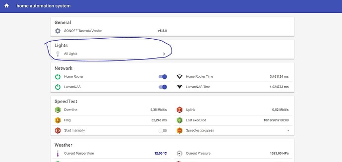

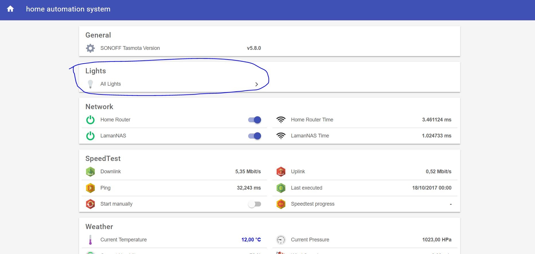

Just as a preview I will show you my first openHAB2 installation homepage:
Google Photos

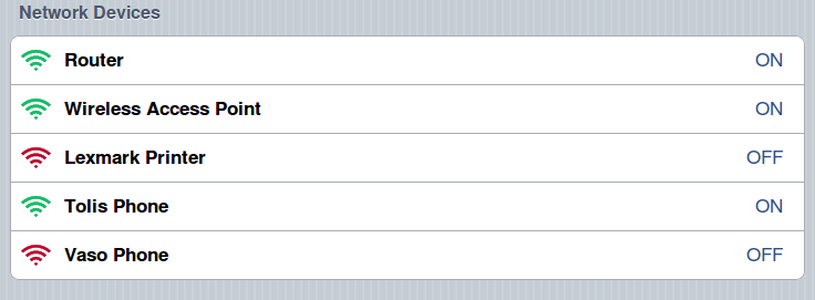

May I suggest to change your network items status from Switch to Text in your sitemap?
The outcome will be something like this:
Hi Apostolos, thanks for your tips. I will apply it soon
Cheers
or like this :slightly_smiling_face:

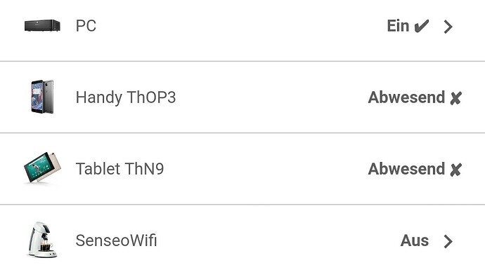

In fact, it’s not a simple On/Off socket. I’ve hacked my Senseo to include a small micro controller to connect via WiFi. It is now able to report its state, turn on/off, detect a cup and brew coffee (after prior preparation). This is great in the morning!! Usage stats are btw persisted to InfluxDB :wink:
@Confectrician you could try to adopt my solution.
Check out the project repository for more:
