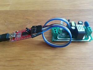

The process is quite easy:
  1. Order whichever modules you want to use (obviously, check compatibility)
  2. Access the on-board serial interface (check the wiki Hardware section)
  3. Flash Sonoff-Tasmota via PlatformIO
  4. Connect to AC power
  5. Configure Wifi by using one of the provided configuration modes: Button Usage
  6. Connect to the device webpage
  7. Select the correct Sonoff module type from the configuration frontend
  8. Configure the MQTT broker connection, choose a unique topic, e.g. “sonoff-A00F9D”
  9. Test communication with the MQTT client of your choice (e.g. mqtt-spy)
  10. Integrate with openHAB!

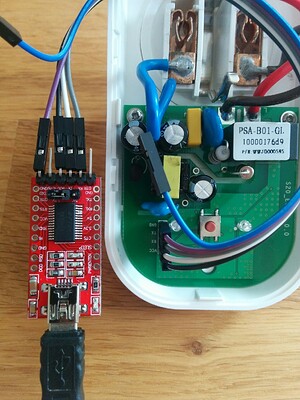

Flashing without soldering, using Pogo Pins (P75-LM2 / P75-LM2 or P75-T2):

Sadly you are right with the conclusion that the linked tutorials are not too good. But let me assure you, the process is really simple/comprehensible. Here are the steps as I remember them:

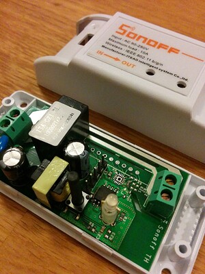

  1. Open up the Itead module and solder the 4-5 pins to it. Minimal soldering experience, pins and jumper cables are required (have a look at the four pictures above) (If you have access to a soldering iron but neither pins nor jumper cables, you can solder wires onto the PCB and the Programmer… not recommended)
  2. Connect to the programmer as in the pictures. Be careful to not mix up the order
  3. Connect to PC via USB
  4. Install Arduino IDE and the needed libraries as described here. You can skip the second part beginning with “Install php…”
  5. Go to the main page and click “Clone or Download” → “Download ZIP”. Extract and open the file sonoff/sonoff.ino with the Arduino IDE
  6. After the configuration in (4.) you should now be able to set up and then upload the program as described here
  7. After successful upload, reconnect the USB cable to reboot the device. After a few seconds it should be up and ready to connect to your Wifi. The default setting is to make a connection via WPS. Push the WPS button on your router and the device should connect and be visible in your routers list of devices (not tested by me),
    Alternatively, you can ask the device to create it’s own Wifi. As written here: “four short presses start Wifi manager providing an Access Point with IP address 192.168.4.1”. You can use your smartphone to connect to the wifi and browse http://192.168.4.1
    There are a few more options. The obvious one would be to set your Wifi SSID and password in the file user_config.h before uploading. I did not follow that path as I plan to move my device to another Wifi soon and do not want to open and reprogram it every time…
  8. After everything went well and your module is connected to your wifi and got an IP address you can browse its web interface with all options and details.

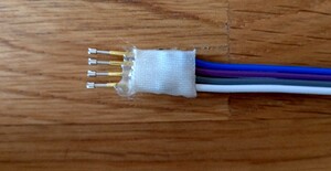

It’s the very common size of 0.1" / 2,54mm pin headers. If you own some tinkering hardware like an Arduino or similar you should already have them lying around. You will also need jumper wires as seen in my pictures. The links are random examples… Good luck :wink:
