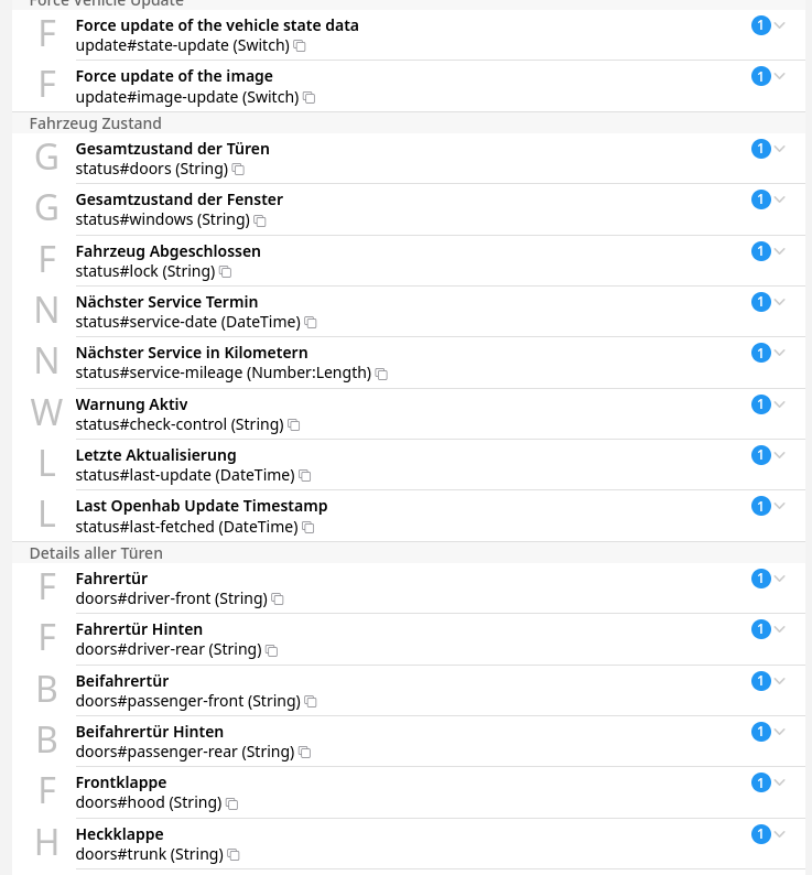

First of all, many thanks for this cool binding. E-mobility can now take off.
I have been using this binding for a very short time now. Am I doing something wrong or why does the captcha have to be reset again and again? Is the old token not saved somehow? I think it has something to do with the bridge and the saved tokens. Is it possible that an initial setup is always carried out when the token exists? I have tried the text configuration and also the UI.
This line in the code looks like it.

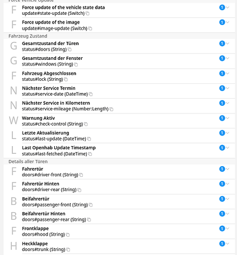

Hi @pstephan that’s interesting. So far we got the error only in the channel last-fetched. There must be something in the way OpenHab reads the thing-update.xml.
You can resolve the issue if you delete the vehicle thing (click twice if it stays in “removing” state) and start the discovery to get it back again. If you didn’t change the ID of the thing, the channels should be automatically linked again after re-creating the thing. You can see it if there are blue “1” icons next to the channels in the thing:
Hi @csowada , are you restarting OH continuously? If it stays running you should not have to create a new token anytime. And with the latest change, the token should be even surviving a restart…
Thanks @MartinOpenhabFan ! That actually worked.
For whoever has the same issue, originally I have always created the vehicle manually (and not through Auto discovery). Using the above resolved the issue.
FYI I am on 15 min interval for updates.
I really wish it was the case for me (2 cars). I have removed them one by one and added them via the Paper UI - “+” - MyBMW - Scan - [car1] [car2].
Maybe I should have removed them both and then went for scan and add?
