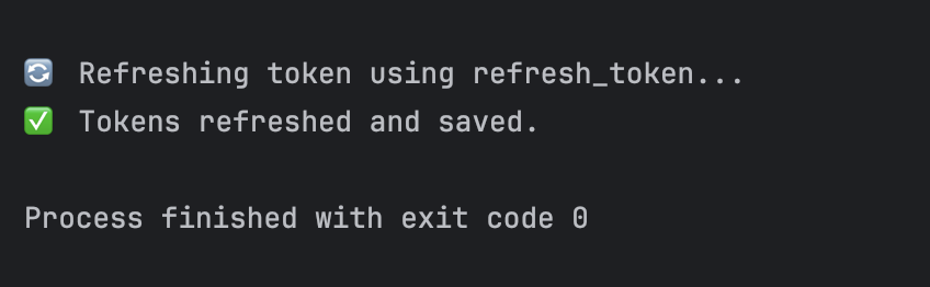

image848×262 16.3 KB
:tada: :tada:
THX for the tip! I changed the code so I doesn’t matter if you use upper or lowercase… now I’m going to make a script to get the data and update an item… Will post the script as well if it works. I also reworked the script a bit so you only need to make a tekst file bmw_tokens.txt. and add the Client ID:………. (exact like this) then run the script. if you don’t have tokens it will get them if you do it wil refresh…

    keepAlive=60]{    Thing topic bmw_vehicle_iX2 "iX2 BMW Vehicle Data" {        Channels:            Type string : raw_data "Raw Vehicle Data" [ stateTopic="your_gcid/your_VIN/#" ]       }
also in the a items file
String BMW_iX2_RawData "BMW iX2 Raw Data \[%s\]" { channel="mqtt:topic:iX2_bmw_streaming:bmw_vehicle_iX2:raw_data" }
I think you have it all. If I forgot something or something isn’t working let me know. :slight_smile:
I would recommend to create a dedicated thread for your approach in the solutions category.
The binding is dead and currently no know is willing to create a new own.
I’m running OH in a docker. The call to run de python files looks like impossible. What is the solution for this? I can run the python files in VSC in a terminal.
I’m not familiar with docker but I do now that it is a virtual enviment. so normally it should work like the rest. the only you should do is find the location in docker of the script and past that in de the rules file.
this part
val result = executeCommandLine(Duration.ofSeconds(30), "/bin/bash", "-c", "cd /etc/openhab/scripts && source /etc/openhab/bmw_venv/bin/activate && python BMW_Tokens.py")
    if (result !== null) {
        logInfo("BMW Token Refresh", "Tokens refreshed successfully: " + result)
        // Wait a moment for the token file to be updated
        Thread::sleep(2000)
        // Step 2: Update MQTT password in things file
        logInfo("BMW Token Refresh", "Updating MQTT broker password...")
        val updateResult = executeCommandLine(Duration.ofSeconds(30), "/bin/bash", "-c", "cd /etc/openhab/scripts && source /etc/openhab/bmw_venv/bin/activate && python BMW_refresh_mqtt.py")
