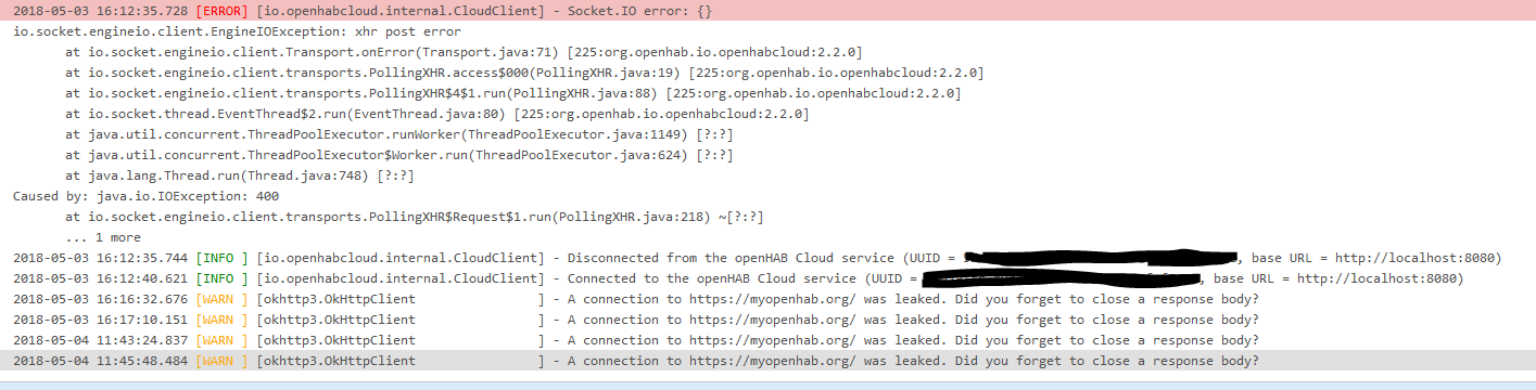

Both are Rpi 3 with the latest OH2. Mine gave IOException: 400. See event.log below.
Does anyone know if this is a security risk? In today’s environment leaks are never good.
