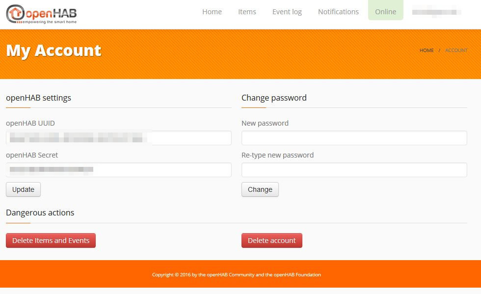

I’m getting a non authorized error now. Where should the uuid and secret be set up please?
2016-12-26 05:00:18.331 [ERROR] [.myopenhab.internal.MyOHClient] - Socket.IO error: not authorized
Mine are set in /usr/share/openhab/webapps/static and correctly configured in myopenhab.org
In your openhab cloud account. Go to
https://myopenhab.org/, login and add your UUID and SECRET to your account.

(but the place where you need to fill in UUID and SECRET is the same in openHAB1 and openHAB2)
