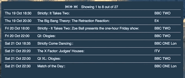

Any chance you could upload a screenshot of your widget please?
Have added a gif. As mentioned in the things to do “it’s not pretty” but it is functional and a little effort well make it stunning I’m sure!
The buttons aren’t really touch/tablet friendly either :hushed:
