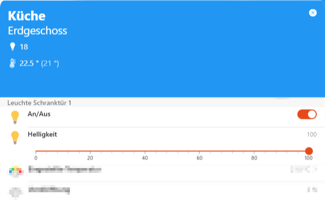

What I’m struggling with in OH3
As you might have noticed, I did not include a section for 1b) Items - Labels because I’m currently struggling with this. From my perspective (maybe shaped from my daily work as a programmer) a main goal in complex systems is to avoid redundancy as much as possible (also known as DRY - don’t repeat yourself).
For the most part I can see this working very well in openHAB3 and the MainUI:
  • Location(Building), e.g. “Main Building”
    • Location(Floor), e.g. “Main Floor”
      • Location(Room), e.g. “Kitchen”
        • Equipment, e.g. “Light Door 1”
          • Point, e.g. “On/Off” or “Brightness”
So the Item that is linked to the Channel would just be called “Brightness”. And this seems to perfectly fit with the automatically generated Location area in MainUI (excuse the german example, I’m too lazy to build an english one, but I think it’s easy enough to understand):
This seems to be very reasonable: Location and the parent of that Location are shown in the header, the Equipment is in the Group title and the actual points below that. All nice and clean, I love it. Especially on smaller devices (smartphone) where every unneccessary word on the screen makes it harder to read (and quite often is truncated otherwise) it is great.

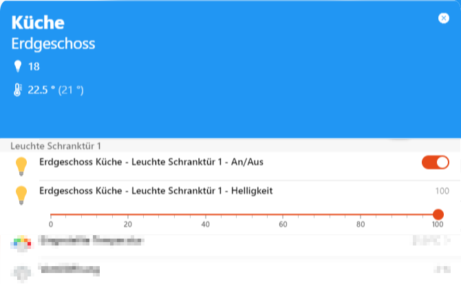

But (you knew there was a but coming and it’s a rather big one :wink: ) almost all other places seem to not agree with this labeling convention:
MainUI Devices Area:
How should I know which room we are talking abour? “Light Door 1” might still give me a clue because I only have those in the kitchen, but I have lots of equipments called “Ceiling Light”. It’s try or error hitting the right one there.
This would be fixable by including the Location (and parent location?) in the header, e.g. “Leuchte Schranktür 1 (Kitchen > Main Floor)” for the example.
MainUI Properties area:
Here it it something different again. All clues to what Equipment this is part of and what room this is part of are missing. To make amends for this, the Item Name is included instead.
While this works (especially with neat item naming conventions like mine :wink: ) I feel like this is also a lost opportunity to really make use of the semantic model.The “Location / parent Location” and the “Equipment” information could (and should imho) be displayed instead of the item name.

So this labeling convention seems to be very logical and works great with the Location tab (which is at least for me the one I think I will spend most time in) but poorly with everything else. So you might suggest the alternative of “cram everything into every Item label”. Then we end up with labels like “Main Floor Kitchen Light Door 1 Brightness” which is neither semantic nor easy to read:
On my 32" desktop it looks manageable (though not pretty and quite redundant) but on my smartphone it is literally unusable:
