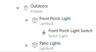

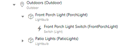

On the Items Page
The Item name is lighter in smaller print (e.g. vRichPresence).
On the model page you don’t even see the Item name by default unless you click on an individual Item.
Though there is a toggle to show the Item name if you need it.

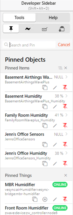

The developer sidebar also emphasizes the label over the name. Clicking the copy icon copies the Item name though.

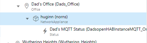

Over time, I’ve moved things around and renamed stuff and I do not always update the names of my Items. For example:
The Item name is “norns” but the label now reads “huginn”. This is because I moved this over to a different host with a different host name. But because I almost never need to see or use the Item name directly, I’ve not bothered to rename the Item. Doing so is more trouble than it’s worth.

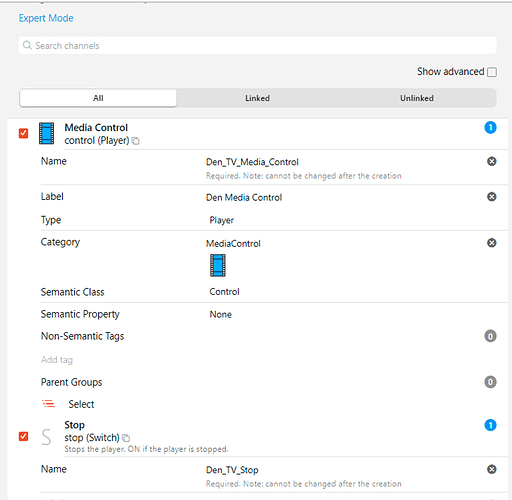

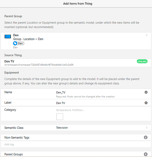

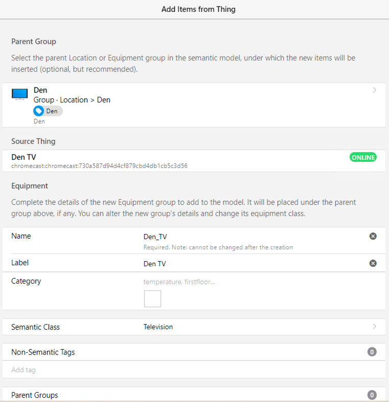

For completeness, here’s a typical “add equipment to model” form.
First choose the Location and create the Equipment.
Further down select the Items you want to create Items for and set the properties for each Item as needed.
