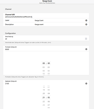

It is so easy via MainUI, why bothering with text files?

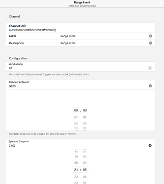

Take the Range Event Channel, klick on Configure Channel:
Make your settings, in this case latest is 21:05 (for summertime) and if the Channel triggers before that add 20min, for today in Germany this would be 16:48 (for wintertime)
Rule Triggers:
DSL: Channel 'astro:sun:shutterkitchen:set#event' triggered START or
JS: triggers.ChannelEventTrigger("astro:sun:shutterkitchen:set#event", "START"),
If you want to display those times you need the set#start Channel from the Starting Time and make the same adjustments, then link that Channel to a DateTime itemtype.
DateTime ShuttersCloseKit { channel="astro:sun:shutterkitchen:set#start" }

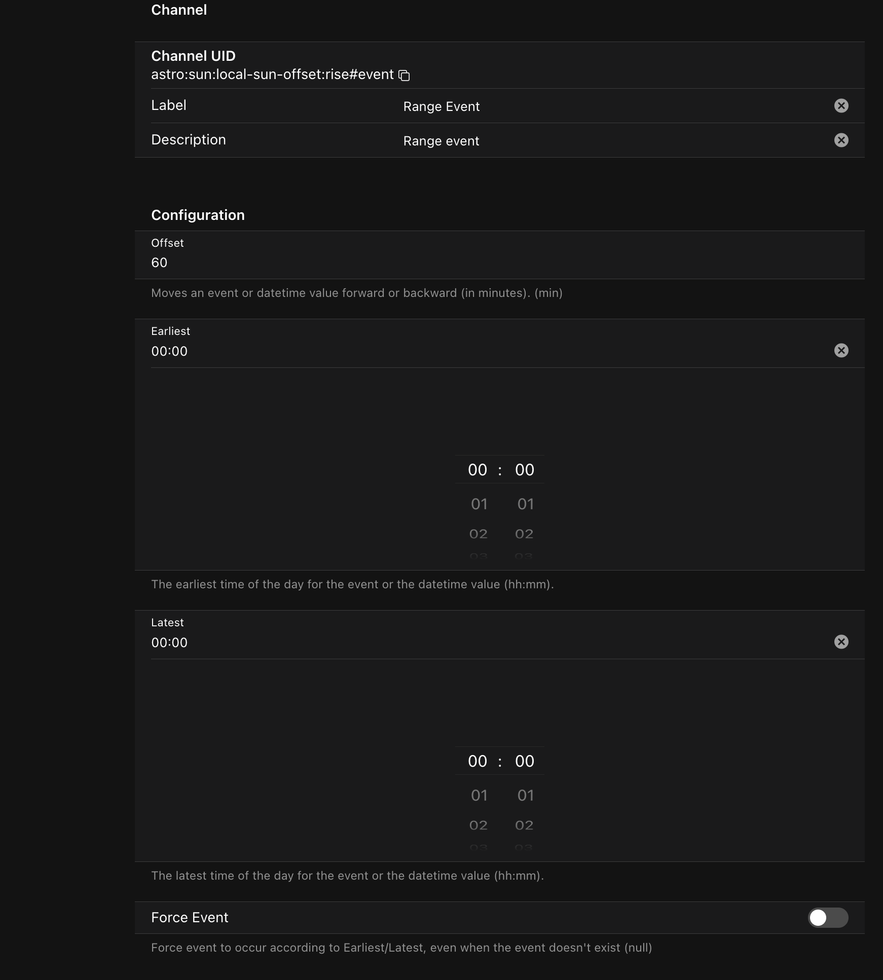

Found the issue I think. If you configure an offset, you MUST also configure earliest and latest, to a time before resp after the offset time could occur, otherwise the offset will fail to apply. This is a bug IMO, will report an issue on github.

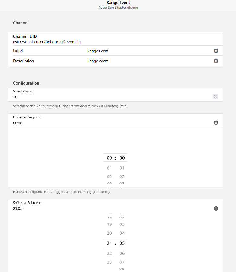

Double check the following:
You need to do the same settings for offset/earliest/latest on the Start Time and the Range Event Channel.
The Start Time Channel needs to be linked to a DateTime itemtype and is not used for triggering, just for displaying:
The Range Event Channel is used to trigger the rules via a Channel trigger:

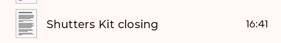

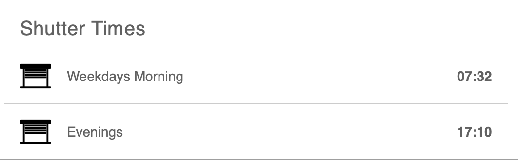

Another Astro Thing shows the Time without an offset:
So for the rollershutter closing time it is exactly the +20 minutes like defined in the setup:

I inspected what happens in the debugger, the issue is here and here. If “latest” is not configured, the original time of the event is used (i.e,. before the offset was added), which causes the offset to be reset.
Just noticed there may be another issue also when using negative offsets, will investigate this more.
Update: for this the bug is in this method (the same as for the latest applies also if “earliest” is not configured), but also, if the default “00:00” is configured, the configuration will be ignored, again returning the original time of the event (before applying offset). So if using negative offsets, setting “earliest” to “00:01” works around the issue.
