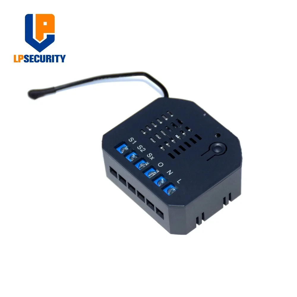

I’d like to affirm the recommendation for Z-Wave. Yes it’s expensive stuff ($40-$60 per light) but it does what you want.
Look at this one, for example:
https://www.aliexpress.com/item/32955594326.html
I don’t have a ton of experience with it, but I bought one, tested it with this non-smart dimmable bulb and was happy and confident enough that I ordered another fifteen of those modules. They’re still in their boxes because just like yours, my house is also being built.
So, does what you want? Yeah. Z-Wave is in no way connected to the cloud, except through openhab (if you want). Local control with a standard switch is a breeze, because z-wave modules have switch inputs!
In fact.. when I first moved into this newly built house last year (also a self-built on the same plot as the main house currently being built), I had my electricians install Z-Wave modules into the walls
before I even had my controller up and running! They’ll work just fine that way.
If it’s too much money to begin with, they’re easy to retrofit and install over time.

Make sure your electrician runs a neutral wire to each wall switch box. The Z-Wave module needs both hot and neutral to function. As long as you have that, you (assuming you feel qualified) can easily put a Z-Wave module in later.
