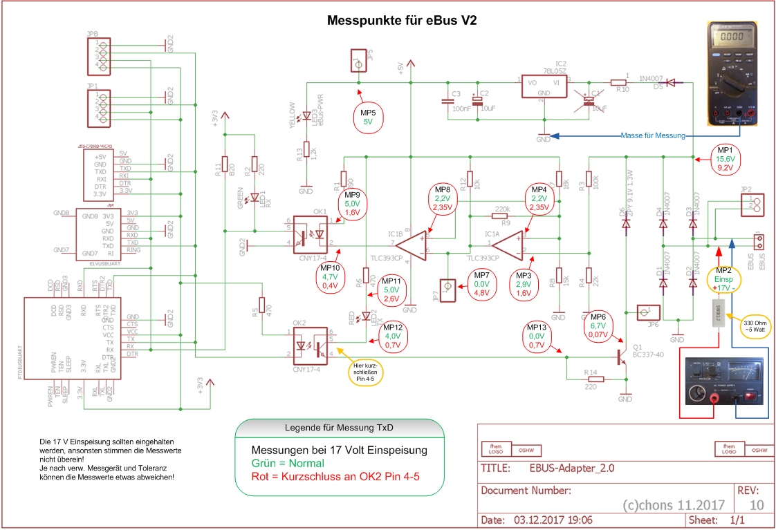

I checked complete schematics and also did a measurements according to the guide :
all values are ok

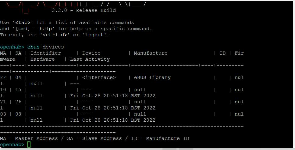

With putty on your box, open the openhab console:
openhab-cli console
Password is normally “habopen” without quotes
Issue command “ebus devices” and show the output.
Use “logout” to get out of the openhab console.

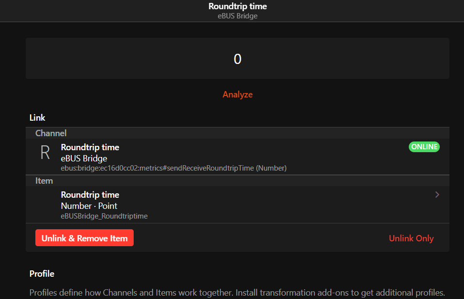

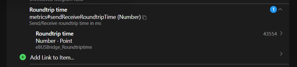

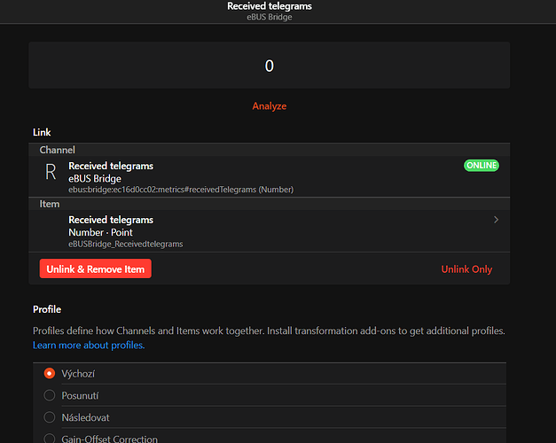

One more thing: what your ebus bridge has a channel (link an item to it) for roundtrip time. What is the value of that one?
but at this moment I have only bridge configured
no thing installed (I deleted when it wasn’t working)
in inbox now I have one standard

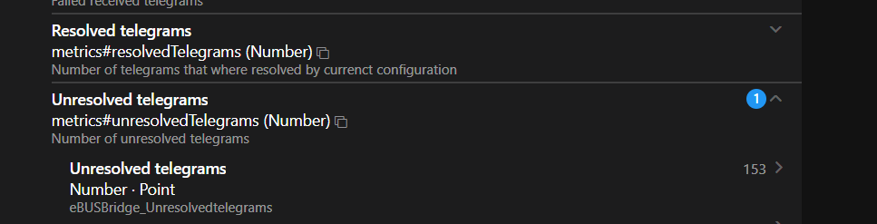

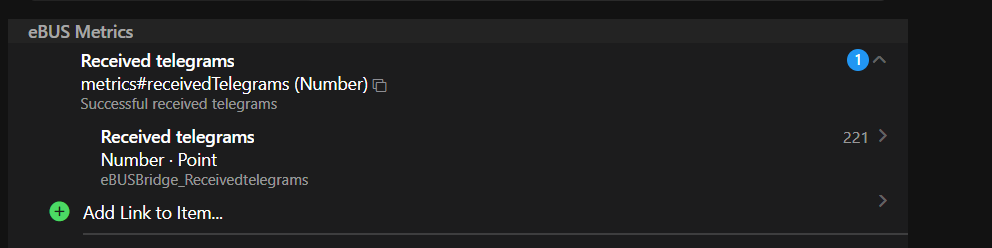

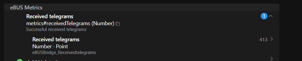

You do have channels, but you have no items linked to them. It would be interesting to see the values for received telegrams and the roundtrip time.
Also from your ebus items it shows that you are not receiving an identifier for any of the addresses, hence the ebus binding will not link the vrc700 to any of them.

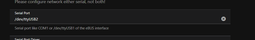

But now you have installed ebusd, are your bridge settings configured to use ebusd or the serial connection?

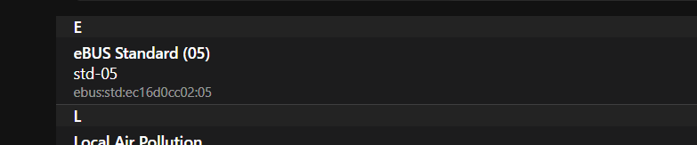

Now I have in ibox 4 devices :

configuration is to serial connection
Roundtrip time seems high. Should be <10000 I believe, but in my case it is about 22000. But I only have a Brink ventilation unit, so very little communication going on over the bus.

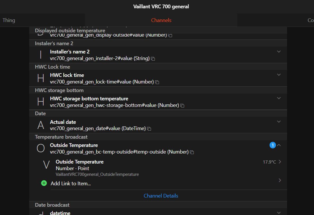

Anyway, what you could try is to manually add a VRC700 thing. In the things menu click the blue plus blow right of the screen, select ebus binding and then manually add a vrc700 thing (best to begin with the “general” one).
Slave address is 15.
Then just link a couple of general items and see if values come in.
Note that some channels have additional configuration possibilities (“configure channel”) where you can set openhab to poll that channel every x seconds (start with 10 and just let it run as a test, usually you don’t need to poll that often). Just try it out if this gives some values.

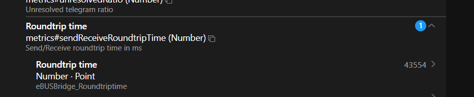

When they are in parallel, possibly ebusd and openhab binding are colliding causing higher latency, and “unstability”. That is why I wanted to try to read your “ebus devices” in openhab-cli console without ebusd running. Just to try to get a device id for your vrc700.

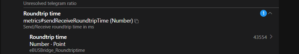

First of all, stop the ebusd (“sudo systemctl stop ebusd”) and check if that changes your roundtrip time.
With ebusd stopped, run the “ebus devices” once more in you openhab-cli console to check if you now get device id’s. If both don’t give better (or other) results, we can always try to make things better by making ebusd and openhab working together.
clear. Thank you for your optimism. First I stopped a a ebusd. Then I checked again a roundtrip time:
and ebus devices from console :

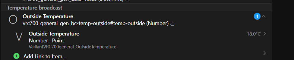

temperature measurement is still working, but a lot of others isn’t working
also data received is still increasing
