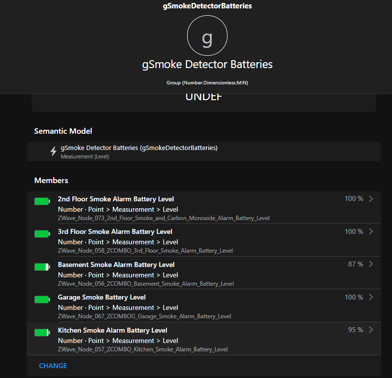

Created a number Group whose members are Battery Levels of my 5 Smoke Detectors.
I was hoping to create an alert when any Detector Battery level drops below a defined level.
The Group value always shows as Undefined but I expected a Number value
The Group yaml is

Update: Revised the Group to remove the Dimension and it’s working.
Did you recently create the group item?
The group item does not look up the group member’s item states to set the initial state once it is created. The group state is updated once a member item gets updated. This can take a while if items are battery-driven, especially smoke detectors have long communication cycles.

This should work with units so I wonder if @Oliver2’s idea is what happened. Battery levels in particular are slow to update usually.
