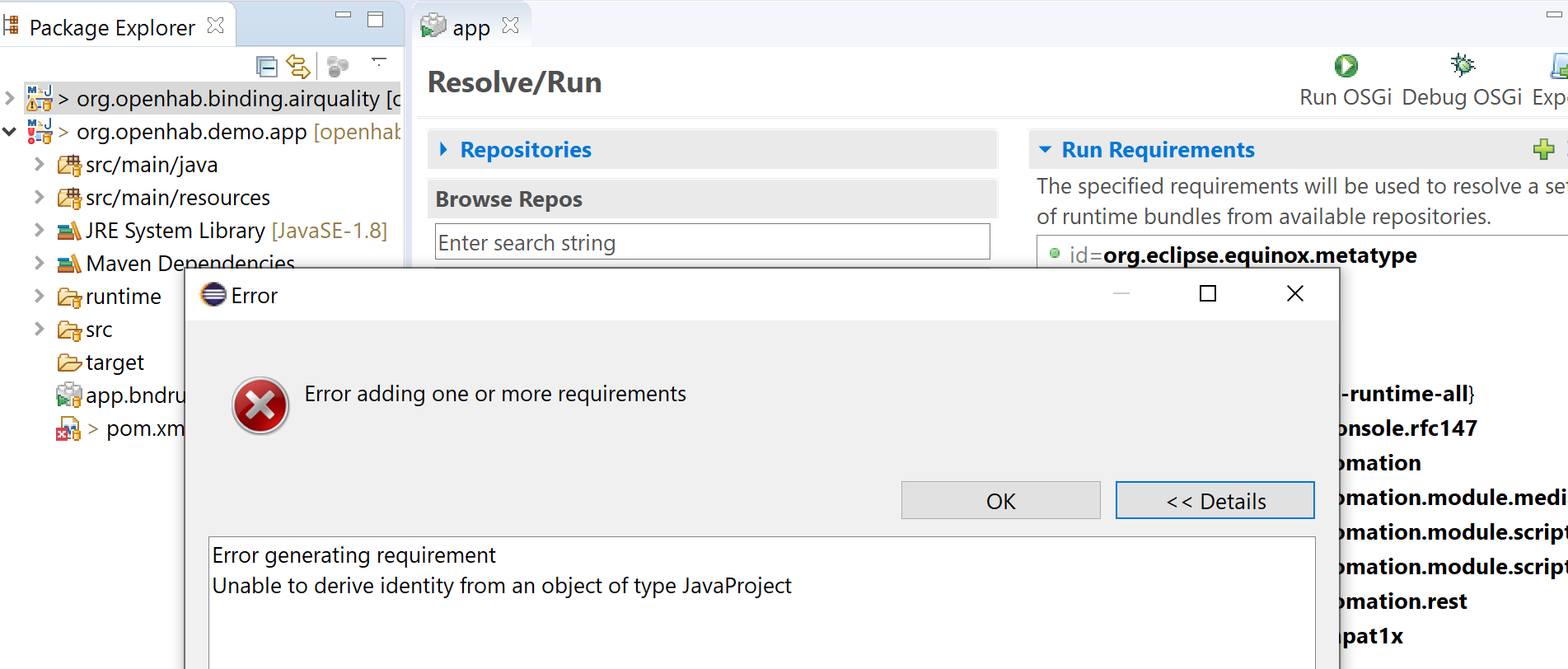

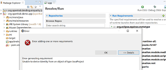

To test my understanding of the build process, I simply started with an existing binding (Air Quality) to see if I can go through the process of building and running it (without making code changes at all). I got stuck at step 8 where I should add the binding to the Run Requirements in bndrun.
I imported the Air Quality binding as existing Maven project and added the Air Quality binding to /pom.xml in org.openhab.demo.app. But if I drag the binding to the Run Requirements, Eclipse comes with an error popup: “Error adding one or more requirements. Unable to derive identity from an object of type JavaProject”.
Looks like I need more guidance here (being totally new to Eclipse IDE).
BTW, if I drag&drop a binding from the Repositories list within the app.bdnrun window, it succeeds.
Have you edited the pom.xml file of the demo app and included the airquality as dependency?
If auto-build is disabled (it is for me, because it ends up in an endless rebuild loop), you also need to right click the demo app, look for “Maven->Update project”.
Unfortunately we need to wait for Markus to come back from his holiday to edit his demo app and add a proper readme file. I also started with guessing and testing out.

UPDATE: I ran Maven->Update project and added the binding ‘manually’ to app.bndrun (edit text file instead of via the plugin) because I had the same error. Did a mvn clean install in the binding directory and successfully generated the .jar file. So far, so good.

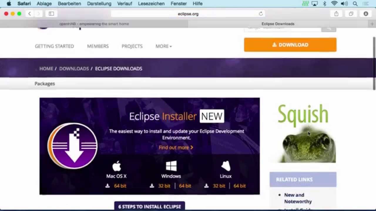

Sorry but that is absolute outdated information in that video.
We have changed the buildsystem and if you use the “openhab2-addons” section in the installer,
you will get the old buildsystem setup, which will utterly break anything for the new system.
Where did you find that video? It should be removed.

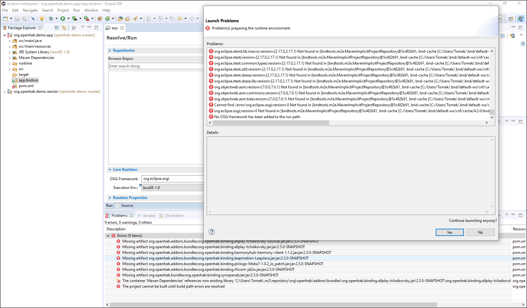

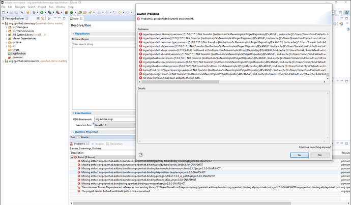

I’ve installed eclipse for Java Developers.
I’ve imported demo-app folder using Import->General->Projects from Folder or Archive
Have you followed the openhab2-addons readme file steps? You need the bnd-something plugin to be installed and you cannot simply click the bndrun->Run file without the build succeeding (which it clearly did not if I look at your errors list).
You need a very recent checkout of the demo. Click on “Project->Build all” to rebuild. It is also known that the allplay binding at the moment is causing problems for the build for some not yet discovered reason.
Hi @Misiu, did you install the latest (201903) version of Eclipse IDE? And also, without any of the repositories during install? Only import as existing Maven project afterwards?
As David said, the README in the Addons Github repository should get you going, at least to come to a setup without those compile/build errors.

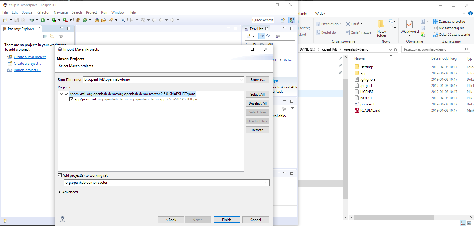

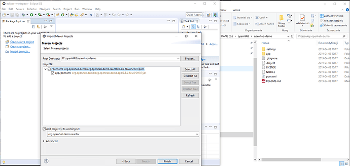

After launch I’ve created a new workspace then in Package Explorer I right click and choose Import.
I’ve picked up Maven->Existing Maven Projects and selected folder where I git openhab-demo.

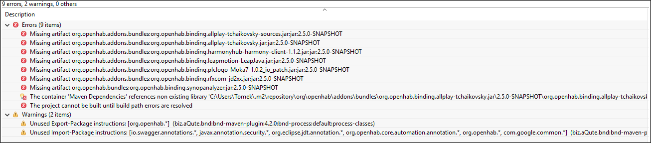

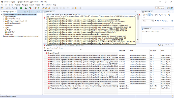

After that I got this errors:

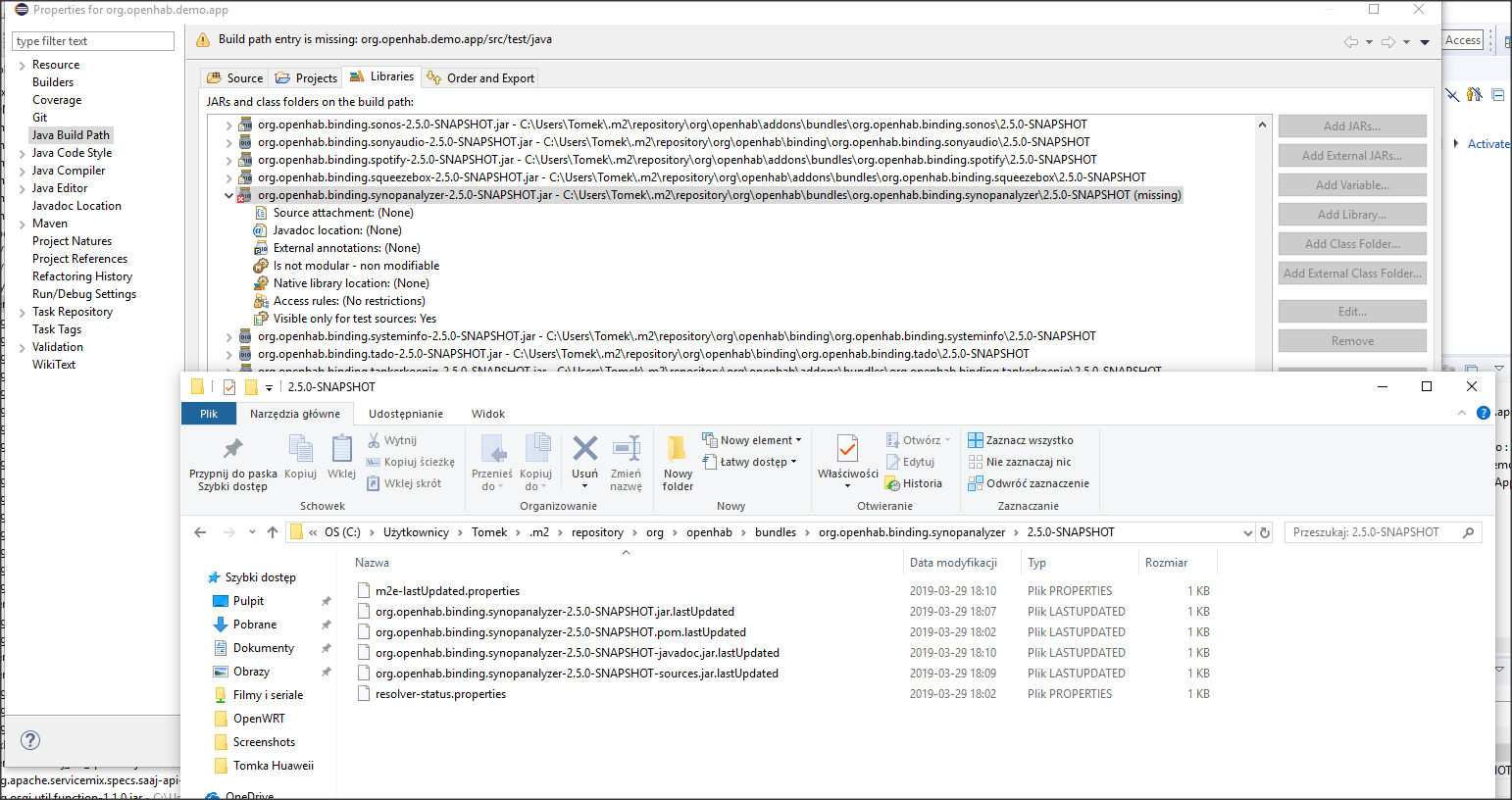

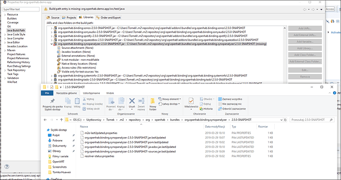

The container ‘Maven Dependencies’ references non existing library ‘C:\Users\Tomek.m2\repository\org\openhab\bundles\org.openhab.binding.synopanalyzer\2.5.0-SNAPSHOT\org.openhab.binding.synopanalyzer-2.5.0-SNAPSHOT.jar’
The project cannot be built until build path errors are resolved
