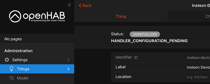

I got my Insteon Hub 2245 discovered with a status of online. My 16 Insteon devices (wall switches, dimmers, etc) show up as Things but with a status **uninitialized". I thought the hub would provide the initialization detail for the Things after I adopted them from the inbox. I need a pointer for next steps to try from here.
Thanks in advance.
What else shows up on the page? At a minimum, you need to configure the product key.

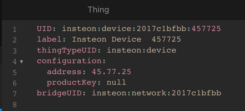

All the Things the came over from the hub look similar. I only have the UID, label, and address. I could set the productKey, but I don’t know what device is at each address listed. Should more config have come over with the adoption of the device? Or do I need to inspect each device physically to determine the productKey?
If you already don’t know, you will need to inspect each device to determine not only the model but also it’s location in your house.

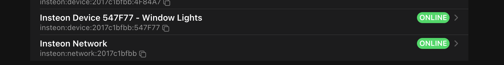

After taking Rob’s advice to inspect the devices to determine their addresses in my house, I have a the hub and few devices devices in the “on-line” state in OpenHab. I haven’t found a quick sanity test to see if they’re controllable though (or least not one that successfully turned on and off the device). That’s my next step.
Got it, Thank you. I could not get my hub online but did get some devicess to show online status. I made a “schedule” to turn a power module off at a specific time - then commenced “run now” to test. My hub’s a problem.
