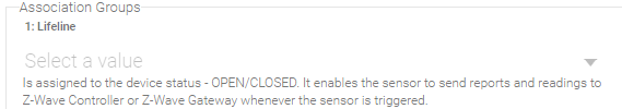

  • Basic Set Level: I can set this value to 255, on some devices OH2 won’t keep/remember the value.
  • PIR function: I can set this value to enabled, on some devices OH2 won’t keep/remember the value.
  • Lifeline: I can set this value to Controller, on some devices OH2 won’t keep/remember the value.

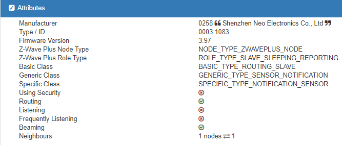

Please can you advise exactly what device you have - please provide the manufacturerId/typeId/ProductId/Version if you don’t know. I need to be able to correlate your device against the database, and at the moment, I can’t.
Hi Chris,
This is the information from HABmin:
I also tried a fresh installation OH unstable 2.5, no difference.
The device you have is this one.
The database was updated and the binary sensor was removed - just use the motion sensor which appears to be reporting fine based on your logs above.
There are multiple versions of the device - some have this sensor, some don’t. As it’s not possible to differentiate the devices, it is included in all.
