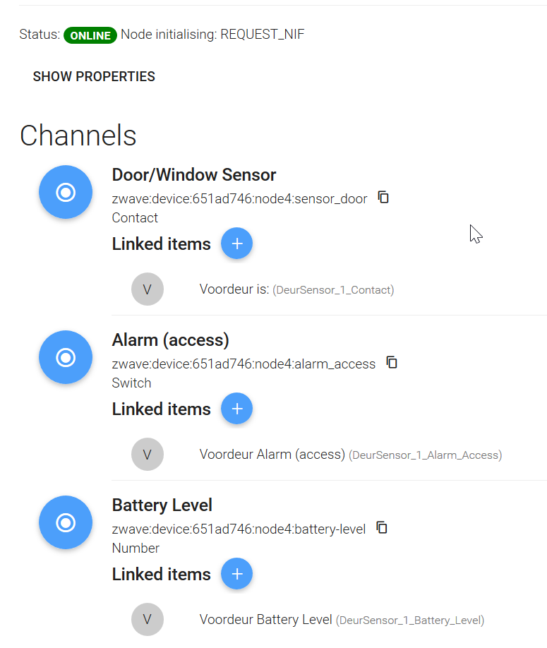

Since i upgraded my system to 2.4.0 i am having problems with my Neo Coolcam Door/Window (4) and PIR (1) sensors. I followed the procedure described by @Chris in this thread ZWave binding updates , so i deleted all Things and let the binding discover them again. Then i added my item definitions from the items file to the Thing items.

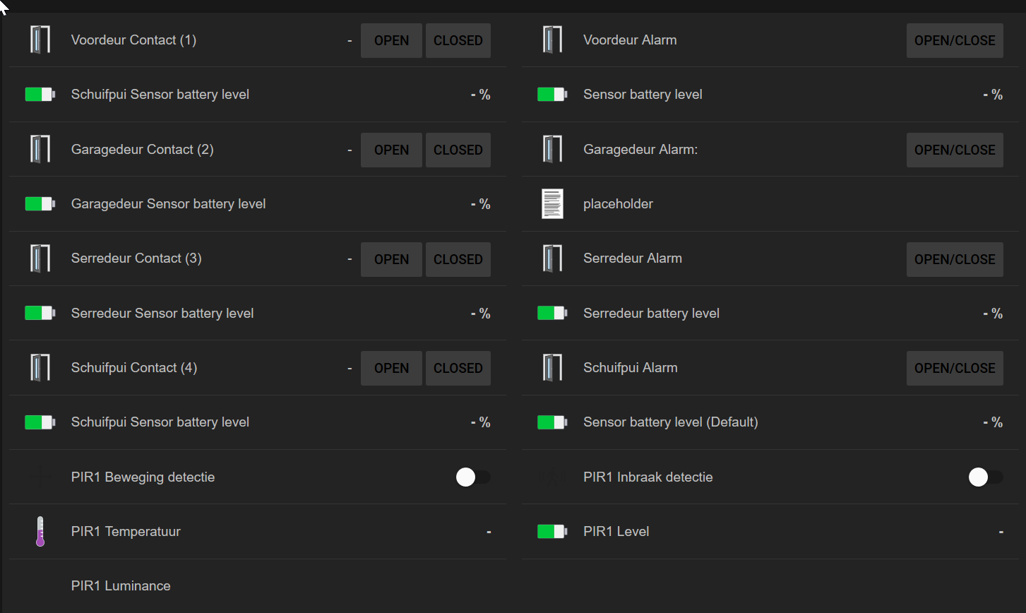

This ia my sitemap snippet:
Group item=gTest label="Test pagina sensors" icon="sensor" {
Switch item=DeurSensor_1_Contact label="Voordeur Contact (1)" icon="frontdoor"
Switch item=DeurSensor_1_Alarm_Access label="Voordeur Alarm" icon="frontdoor" mappings=[ON="OPEN/CLOSE"]
Text item=DeurSensor_1_Battery_Level label="Schuifpui Sensor battery level [%s %%]" icon="batterylevel"
Default item=DeurSensor_1_Battery_Level label="Sensor battery level [%s %%]" icon="batterylevel"
Switch item=DeurSensor_2_Contact label="Garagedeur Contact (2)" icon="frontdoor"
Switch item=DeurSensor_2_Alarm_Access label="Garagedeur Alarm: " icon="frontdoor" mappings=[ON="OPEN/CLOSE"]
Text item=DeurSensor_2_Battery_Level label="Garagedeur Sensor battery level [%s %%]" icon="batterylevel"
Text item=placeholder
Switch item=DeurSensor_3_Contact label="Serredeur Contact (3)" icon="frontdoor"
Switch item=DeurSensor_3_Alarm_Access label="Serredeur Alarm" icon="frontdoor" mappings=[ON="OPEN/CLOSE"]
Text item=DeurSensor_3_Battery_Level label="Serredeur Sensor battery level [%s %%]" icon="batterylevel"
Default item=DeurSensor_3_Battery_Level label="Serredeur battery level" icon="batterylevel"
Default item=DeurSensor_4_Contact label="Schuifpui Contact (4)" icon="frontdoor"
Switch item=DeurSensor_4_Alarm_Access label="Schuifpui Alarm" icon="frontdoor" mappings=[ON="OPEN/CLOSE"]
Text item=DeurSensor_4_Battery_Level label="Schuifpui Sensor battery level [%s %%]" icon="batterylevel"
Default item=DeurSensor_4_Battery_Level label="Sensor battery level (Default)" icon="batterylevel"
Switch item=NeoPIR_1_sensor label="PIR1 Beweging detectie" icon="movecontrol" mappings=[ON="OPEN/CLOSE"]
Switch item=NeoPIR_1_burglar label="PIR1 Inbraak detectie" icon="motion" mappings=[ON="OPEN/CLOSE"]
Text item=NeoPIR_1_temperature label="PIR1 Temperatuur [%s]" icon="temperature"
valuecolor=[Last_Update=="Uninitialized"="gray", >=25="orange", >=15="green", 0="white", <15="blue"]
Text item=NeoPIR_1_level label="PIR1 Level [%s]" icon="battery"
Text item=NeoPIR_1_luninance label="PIR1 Luminance" icon="licht"

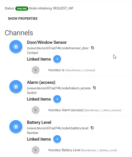

When i look at PaperUI, at the Things i see this: Status: ONLINE Node initialising: REQUEST_NIF
