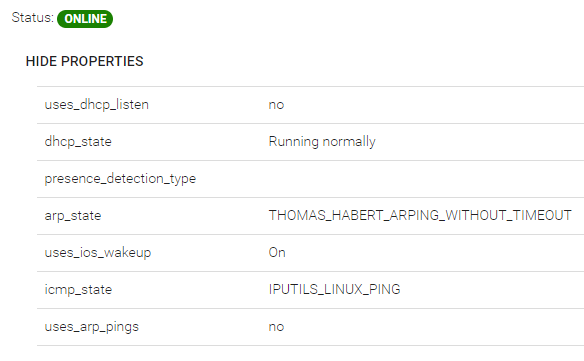

Thanks, but I done everything on that page, installed arping, set permissions, forwarded DHCP port, tested as I saw in this tread that I can arping from command line. But still get my files properties like this:
uses_dhcp_listen no
dhcp_state No access right for port 67. Bound to port 6767 instead. Port forwarding necessary!
presence_detection_type ARP_PING
arp_state THOMAS_HABERT_ARPING_WITHOUT_TIMEOUT
uses_ios_wakeup On
icmp_state IPUTILS_LINUX_PING
uses_arp_pings no
So I thought it would be some other command to pass permissions. I have a clean install raspberry pi3 with rasbian lite and Openhab installed as apt-get.

Permissions are ok then. But file properties say “no arping” do I need to set the full path “/usr/sbin/arping”?
File properties are things you set to configure the binding. They don’t set themselves. It wouldn’t hurt to set the full path but you also need to set uses_arp_pings to yes

I created the network.cfg file but it did not work, I guess that those file on “/services” are bindings configurations and we are trying to change a “thing” attribute that is already default on the binding as it has the arping path. The doc is not very clear how we do that, as the only attributes it offer for “things” are retry, timeout and refleshInterval. Still not sure how to get it to work.
There is no arp ping setting to make on a Thing.
See https://docs.openhab.org/addons/bindings/network/readme.html
I don’t think you can configure arping on a Thing by Thing basis. It is all or nothing meaning it is a binding level config, not a Thing config.
Now that I look there is no uses_arp_pings setting. @andredts, where are you seeing these properties?
Those properties can be found on Paper UI Configurations/Things. Then below the status of your, you have a button “Show properties”.
That isn’t a configurable property.
If arping is set up and you can run it from the command line without root access, the Network binding will use it if necessary. If it’s necessary, and it’s currently using it, then that Property will show Yes.
