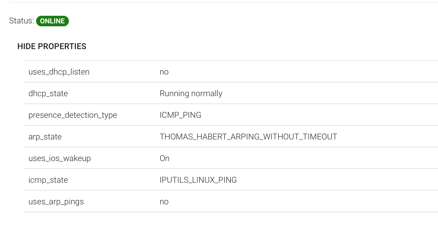

My thing properties shows as follows:
uses_arp _pings is no

I will post screenshots of my settings once I am on my computer again

And what I see now, it is 15:26 system time :
Device
OFF
Device Response Time

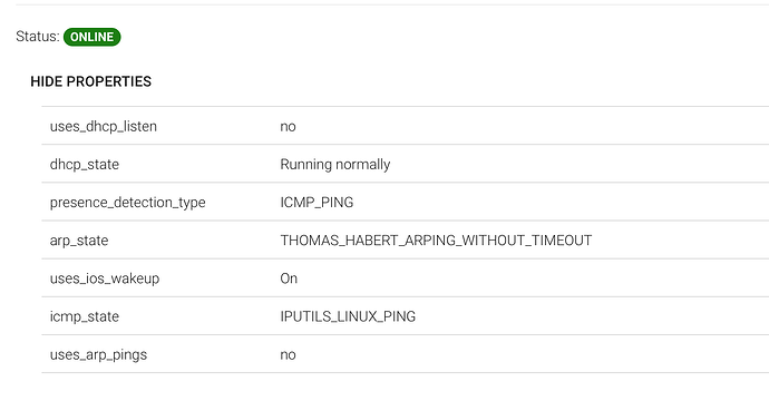

uses_dhcp_listen
no
dhcp_state
No access
right for port 67. Bound to port 6767 instead. Port
forwarding necessary!
presence_detection_type
ARP_PING
arp_state
IPUTILS_ARPING
uses_ios_wakeup
On
icmp_state
IPUTILS_LINUX_PING
uses_arp_pings
nonetwork.cfg
uses_apr_pings=yes
allowSystemPings=false
