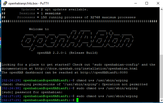

I tried to do: chmod u+s /usr/sbin/arping
But openhabian returns this error:
chmod: cannot access ‘/usr/sbin/arping’: No such file or directory
Any suggestions what to do now?

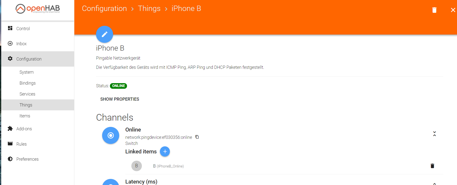

The file does not exist. I think you need to reinstall arping. Also it does not seem like you’ve connected the items to the network thing
salexes
(Salexes)
January 12, 2018, 12:13am
6

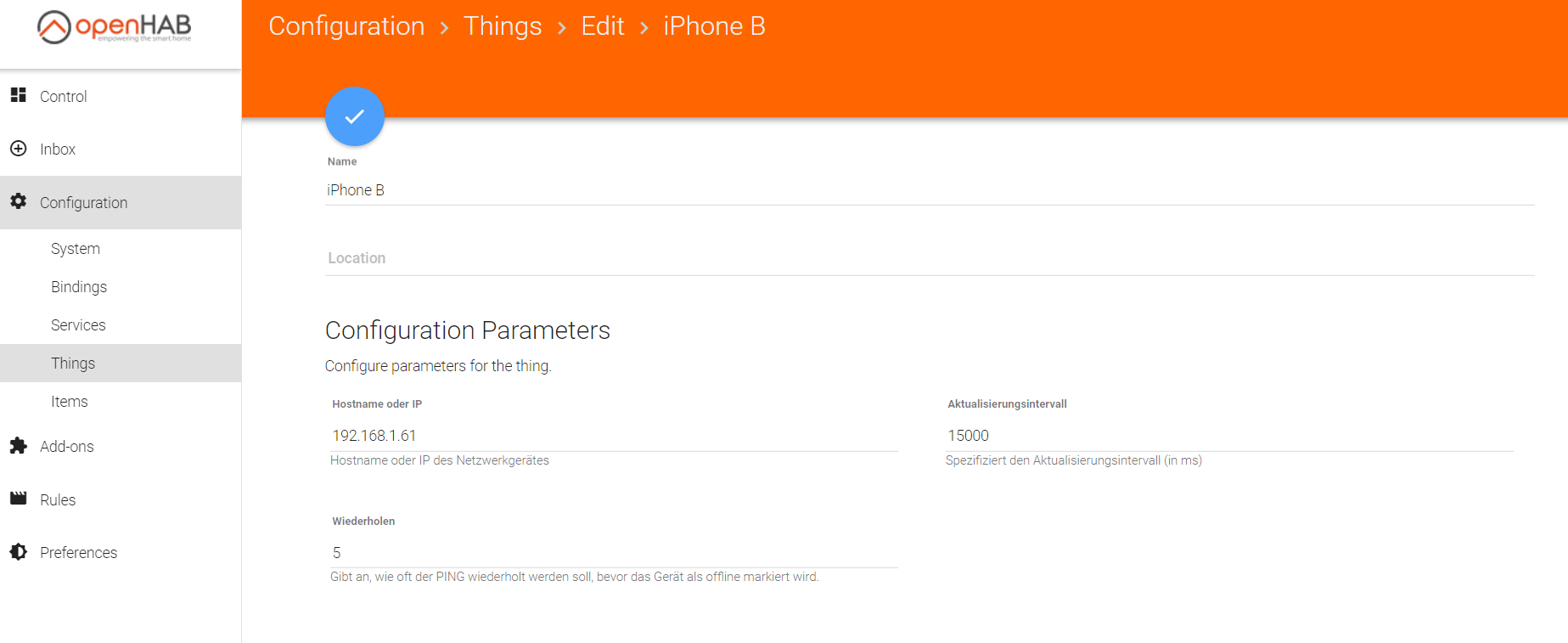

As you can see in the screenshot above the item iPhoneB_Online is linked with the network:pingdevice:ef03056:online
And this are the settings of my Thing
furthermore i reinstalled arping and run this command: sudo chmod u+s /usr/sbin/arping
but it is still not working as it should, what else could the issue be ?

Yes See the screenshot above.
I did everything correctly, right ?
