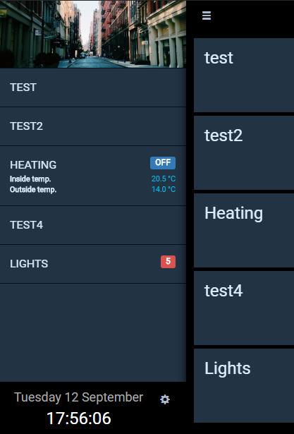

Just notifying you I just added some options to further customize your HABPanel side drawer and dashboard headers - two of the remaining places where customization was not easily possible:
And for those of you who like to play with this stuff, you are now able to customize those per dashboard with custom widgets - meaning you can put whatever you want in those places (within reason) :grin:
There was already an ability to customize the dashboard tile in the main menu this way, I simply reused the concepts for the drawer menu and the header.
Obviously, there could be unintended consequences if you’re not careful so these options are labeled “experimental” - nonetheless I’m curious what you’ll eventually come up with :blush: You’ll find them in the third tab of the dashboard’s settings dialog, accessible from the main menu in edit mode.
It’s recommended to keep your widgets simple, without interactive features (like ng-click or buttons, sliders etc), furthermore they might not look exactly like the preview in the widget designer because additional CSS classes are applied.
Here are a few possible uses of this feature:
Changing the side drawer menu entry for a dashboard
Tip: use ngModel.name to get the dashboard’s name.
Example 1:
<span>{{ngModel.name}}</span> <span class="pull-right label label-primary">{{itemState(config.label_item)}}</span>
<dl style="padding: 0; margin: 0; font-size: 8pt; text-transform: none;">
  <dd class="pull-right value">{{"%0.1f °C"|fmt:+itemState(config.first_details_item)}}</dd>
  <dt>{{config.first_details_label}} </dt>
  <dd class="pull-right value">{{"%0.1f °C"|fmt:+itemState(config.second_details_item)}}</dd>
  <dt>{{config.second_details_label}} </dt>
</dl>
Config settings types: label_item: Item, first_details_label: String, first_details_item: Item, second_details_label: String, second_details_label: Item
Example 2:
<span class="label label-danger pull-right">{{(itemsInGroup(config.group_name) | filter:{state:'ON'}).length}}</span>
Config settings types: group_name: String
Result (after setting and configuring the widgets):

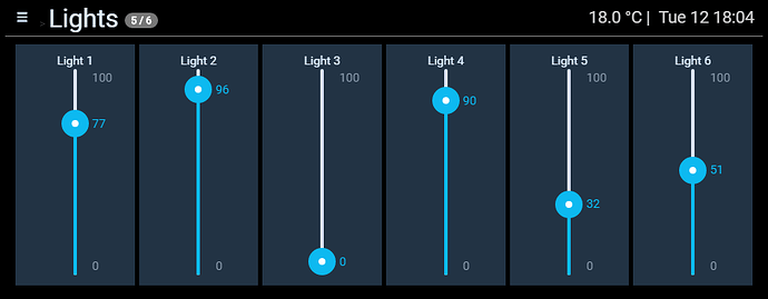

Changing the dashboard header
Example 1
<h2 class="dashboard-title">
  {{ngModel.name}}
  <span class="badge">{{(itemsInGroup(config.label_group_name) | filter:{state:'ON'}).length}} / {{(itemsInGroup(config.label_group_name)).length}}</span>
  <small class="header-clock">
    <ds-widget-clock show-digital digital-format="'EEE dd HH:mm'"></ds-widget-clock>
  </small>
    {{'%0.1f °C' | fmt:+itemState(config.header_item)}} |
  </small>
</h2>
<hr style="margin-top: 4px; margin-bottom: 0; border-top: 1px solid #777;" />
Config settings types: header_item: Item, label_group_name: String
Result (after setting and configuring the widget)
Again, use with caution, but hope it helps!
Cheers :slight_smile:
