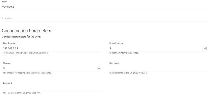

Hard for me to give you details. It was your last change from last weekend 3.5.2020
I changed the .jar file and did a reboot of openHAB afterwards it was not possible to control anything in the sitemap. (I used your sitemap example all the time) - nothing in log
Make sure you have the timeout set:

I fixed some problems this week. So please try the following steps:
  1. delete your thing in paper-ui
  2. delete the old jar in add-ons folder (wait until the binding disapears in paper-ui bindings view)
  3. download the current jar and place it in the add-ons folder
  4. do auto discovery in paper-ui and add the thing check that the timeout parameter is set
  5. reboot your open-hab instance
After these steps evreything should run fine. If there are problems left, please go to karaf-console and perform
  1. log:set DEBUG org.openhab.binding.enigma2
  2. log:tail

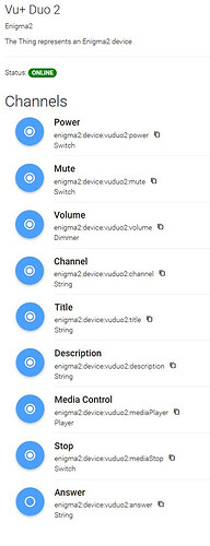

Unfortunately with the newest version my VU Duo2 does not have all channels available anymore :joy:
207 │ Active │ 80 │ 2.5.5.202005091733 │ openHAB Add-ons :: Bundles :: Enigma2 Binding
Pushing the buttons for the missing channels does of course not showing anything in the logs:
https://gist.github.com/sihui62/375113c8cae999a6a0e8c83019801a5b
I removed the old jar, cleared cache and tmp, added the new jar, restarted openHAB, autodiscovered the Thing (which did not work either, I had to manually add the Thing).
@sihui:
I checked your logs and everything seemed to be ok. There is no error and I found log entries for refreshing the missing channels:
2020-05-10 19:47:16.662 [DEBUG] [nding.enigma2.handler.Enigma2Handler] - handleCommand(enigma2:device:vuduo2:channel,REFRESH)
2020-05-10 19:47:16.663 [DEBUG] [nding.enigma2.internal.Enigma2Client] - Transmitting http://192.168.2.25/web/subservices
2020-05-10 19:47:16.669 [DEBUG] [nding.enigma2.handler.Enigma2Handler] - handleCommand(enigma2:device:vuduo2:title,REFRESH)
2020-05-10 19:47:16.683 [DEBUG] [nding.enigma2.handler.Enigma2Handler] - handleCommand(enigma2:device:vuduo2:description,REFRESH)
So the channels must be there, otherwise OpenHAB might not be able to request a refresh.
There ist also a log where you send a command to the mediaStop-channel:
2020-05-10 19:47:48.126 [DEBUG] [nding.enigma2.handler.Enigma2Handler] - handleCommand(enigma2:device:vuduo2:mediaStop,ON)
2020-05-10 19:47:48.133 [DEBUG] [nding.enigma2.internal.Enigma2Client] - Transmitting http://192.168.2.25/web/remotecontrol?command=128
I tried it out with a full clean install and everything looks fine.
I have no idea what could cause your problems. Can you please download the latest OpenHAB-Snapshot and check if the binding works with a clean installation?
These channels are available, I was looking for the “rcbutton”, “warning”, “error” and “info” channels, but realized after another look in your readme that the channels changed to actions now.
Sorry for the confusion and thanks for looking into this.
