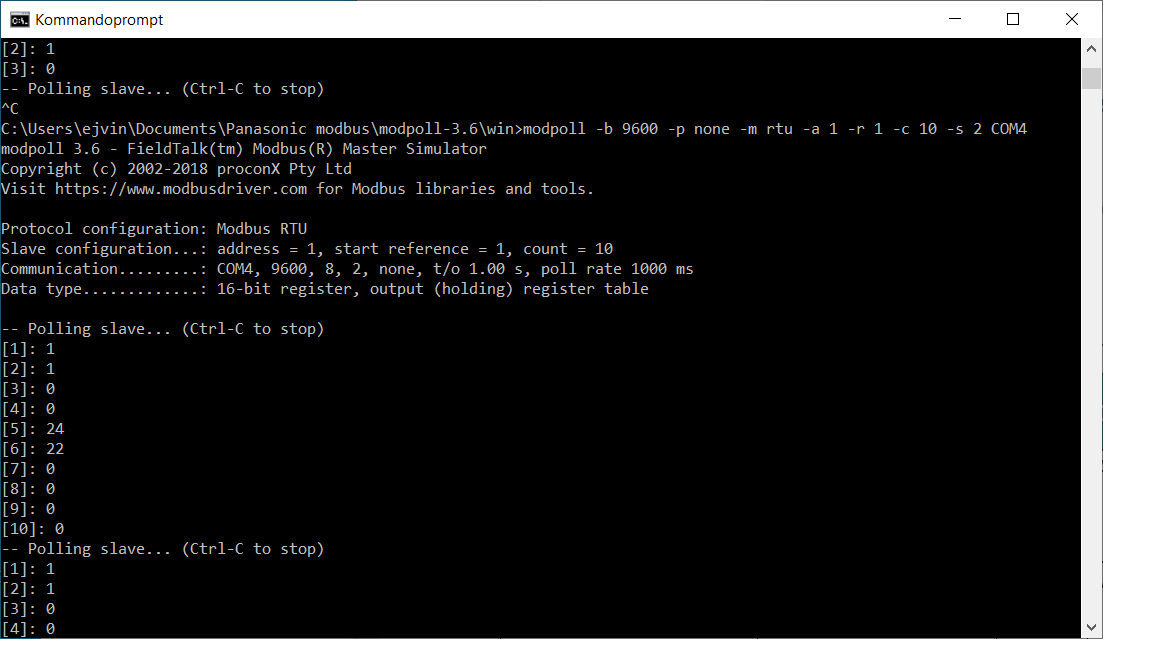

I have a Intesisbox to control Air Condition using Modbus. By using the free Modbus driver here everything is working fine. See picture which also shows the actual parameters used:
where I am fetching 10 registers starting from #1. The connection parameters are 9600 bps, 8 data bits, no parity and 2 stop bits.
Then I am trying to get openHAB binding 2 in version 2.4 to work, but I keep getting
2019-12-03 20:15:15.982 [ERROR] [ernal.handler.ModbusDataThingHandler] - Thing modbus:data:slave01:holdingsREG:ac1unitmode ‘Modbus data’ had ModbusSlaveIOExceptionImpl error on read: ModbusSlaveIOException(cause=ModbusIOException, EOF=false, message=‘I/O exception: IOException Error reading response (EOF)’, cause2=null)
I have tried both paperUI and configuration file, but the result is the same.
My things file looks like this:
Bridge modbus:serial:slave01 [port=“/dev/ttyUSB5”,baud=9600,id=1,stopBits=“2.0”,parity=“none”,dataBits=8,encoding=“rtu”] {
Bridge poller holdingsREG[ start=1, length=2, refresh=4000, type=“holding”] {
Thing data ac1unitonoff [ readStart=“1”, readValueType=“uint16”, readTransform=“default” ]
Thing data ac1unitmode [ readStart=“2”, readValueType=“uint16”, readTransform=“default” ]
and my item file:
Number ac1unitonoff { channel=“modbus:data:slave01:holdingsREG:ac1unitonoff:number” }
Number ac1unitmode { channel=“modbus:data:slave01:holdingsREG:ac1unitmode:number” }
The problem seems to be the poll. Below is the error message shown in paperUI for the poll thing.
Status: OFFLINE - COMMUNICATION_ERROR Error with read: org.openhab.io.transport.modbus.internal.ModbusSlaveIOExceptionImpl: Modbus IO Error with cause=ModbusIOException, EOF=false, message=‘I/O exception: IOException Error reading response (EOF)’, cause2=null
I hope that some smart guys can help me identify the problem. Maybe @rossko57 or @gitMiguel
Thanks!
It’s a read error, not much more to say.
I note that your screenshot refers to COM4, but Thing to ttyUSB5 so clearly we are on different boxes and possibly different serial adaptors.
Serial problems often come down to permissions.
The Modpoll test with the screen shot was done on my Win 10 pc, while my openHAB is running on a linux box. But it is physically the same usb to rs485 adapter I just moved between those 2 boxes.
How can I figure out if there is a permission problem in my openHAB box as you mentioned?
