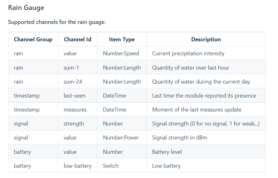

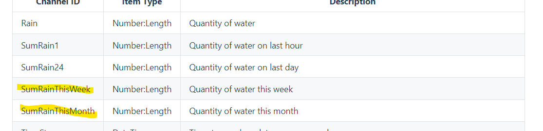

Upgraded to M5 today and just noticed that some rain channels are no longer present in the revised Netatmo binding:
This has been changed in the latest 3.3 documentation:
Question: Does Netatmo no longer support these 2 channels in the API or was this just a change in the binding?

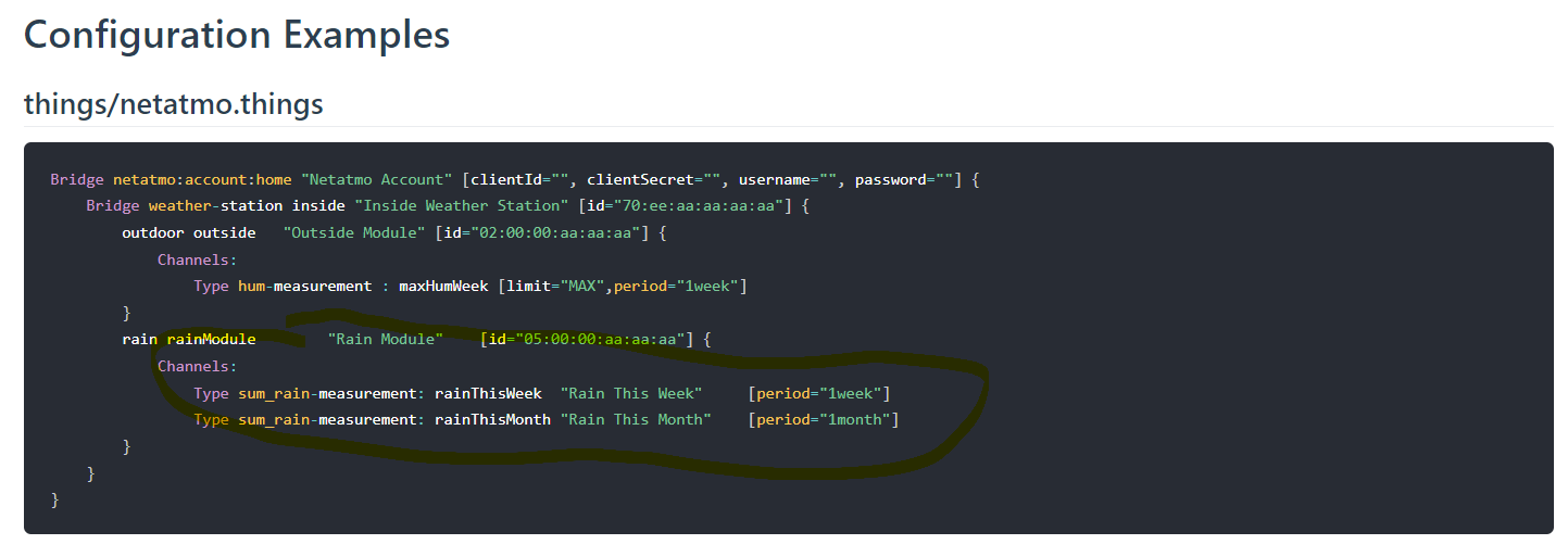

Because in the Doc there is still a configuration example that is no longer working with the current version:
If Netatmo has removed this from the API, I need to find another solution with persistence. Otherwise can we have back these channels?
