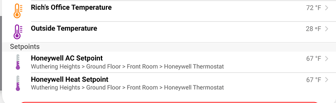

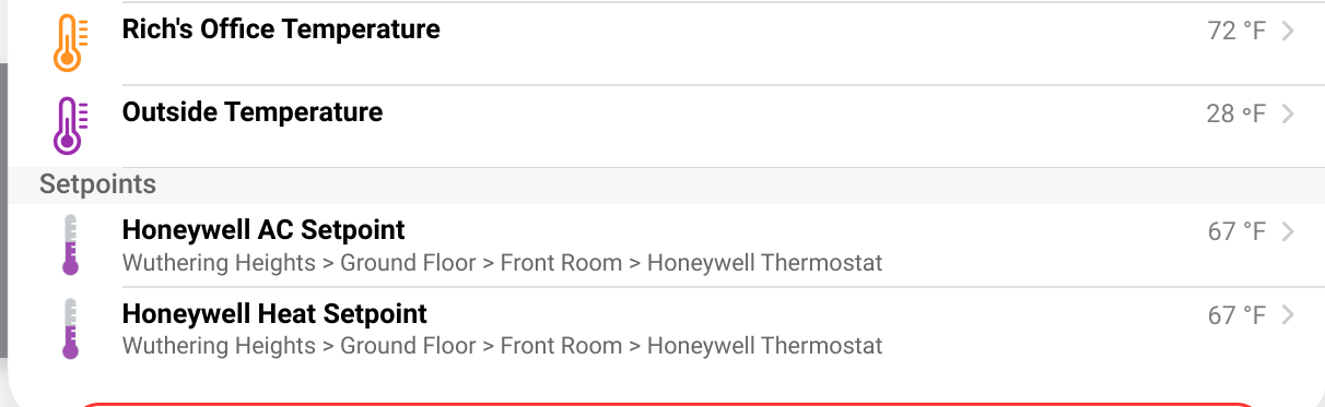

I think they might go away when you define a custom list Item widget for the Item. That seems to be the case for me at least.
I haven’t looked to see what’s different or if there is a new field or something to turn it on or off on a per Item basis but appears to be possible at least.
The first two use my custom List Item Widget (can be found in the marketplace) and the last two are completely unaltered defaults.
I hadn’t noticed that yet (just loaded up the milestone this morning). Defining new custom widgets for everything just to get rid of these is little bit of overkill even for my obsessive nature. Plus, that only fixes the property cards. On the equipment cards the breadcrumbs are in the header lines which we can’t impact with custom widget (to my knowledge).
