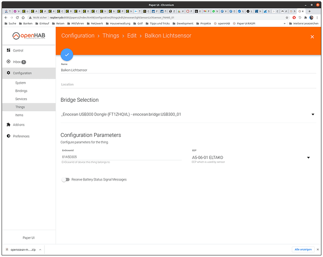

I am using openhab 2.5.10 with the enocean binding from fruggy83, and my configuration since more than a year.
Actually I have some trouble with my etalko FAH60. It seams to me, that the sensor does not get enought light during the daylight to fill its battery using its photo cells. The lux messaring stops some time in the evening at a value of e.g. 33 and restarts with values above 400 lux in the next morning.
I have checked the thing definition and found a switch, to receive battery status signal messages.
I am using thing definition files, so I cannot switch these message on in this dialog. It is competing.
How should I have to modify my thing definition to switch these messages to ON?

Hi Jörg @doko,
you just have to add the config parameter receivingSIGEEP and set it to true. However I am not sure if your FAH60 sends these special messages, but adding this paramter should not make it worse.
Best regards
Daniel

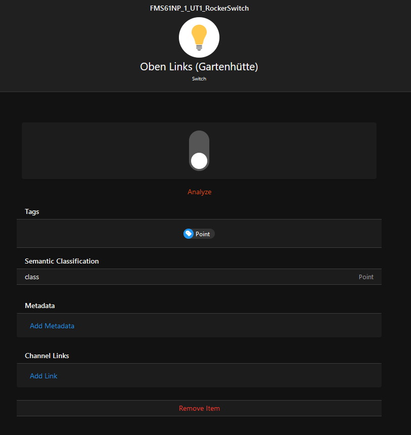

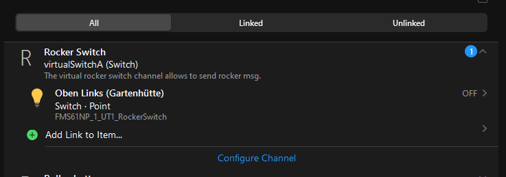

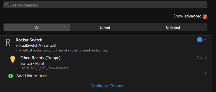

your items FMS61NP_1_UT2_RockerSwitch and FMS61NP_1_UT1_RockerSwitch send both the same messages on ON (F630FF8913043001FFFFFFFFFF00) and OFF (F610FF8913043001FFFFFFFFFF00). Could you please post your config here? Maybe both items are connected to the same channel?
Best regards
Daniel
Thanks @fruggy83 for the feedback. Well I configured to separate Classic Device and both on Channel A:
FMS61NP_1_UpperLeft:
UID: enocean:classicDevice:2bcff03d2a:FMS61NP_1_UpperLeft
label: FMS61NP_1_UpperLeft
thingTypeUID: enocean:classicDevice
configuration:
senderIdOffset: 4
suppressRepeating: false
sendingEEPId: F6_02_01
receivingEEPId: F6_02_01
bridgeUID: enocean:bridge:2bcff03d2a
FMS61NP_1_UpperRight:
UID: enocean:classicDevice:2bcff03d2a:FMS61NP_1_UpperRight
label: FMS61NP_1_UpperRight
configuration:
senderIdOffset: 4
I “copied” manually the config from OH2 Paper UI to OH3 UI.
The config above is comming from the Thing. If I view the config from the Item there is no Channel linked
Hi Tino @flynux ,
both things use the same senderidoffset and both items are linked to channel A (virtualRockerSwitchA). That is why they are both sending the same message. You could do the following. Just use one thing and link one item to channelA and the other to channelB. In this way you just need one senderIdOffset (just in case you have so much devices that you have to save your ids). If you want to seperate the things, you have to use two different senderIds.
Either way you have to do the teach in again.
Best regards
Daniel
@fruggy83 Thanks, senderID is a good point. I thought it gets count up automatically. Anyway I will do some further changes. I have 2 FMS61NP. So it is not to many. Thanks, I will let you know.
