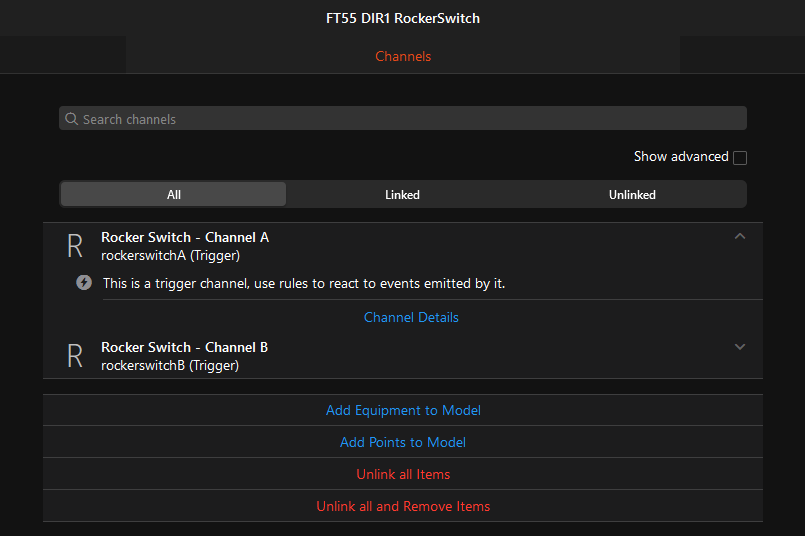

Hi Daniel @fruggy83, I have to open another thread, because for me it looks like that the behavior between OH2 and OH3 is different.
I have a physical RockerSwitch Eltako FT55. In OH2 I was able to add a switch to to Channel A nd B. In OH3 I am not able to do so anymore. It tells me the channel is only for triggers:
So on my FMS61NP I have 2 Classic Device with different senderIDs :-). Both are configured on virtualSwitchA. On one of them I created a Listener. I assume only 1 listener is necessary per physical actuator.
UID: enocean:classicDevice:2bcff03d2a:FMS61NP_1_UpperLeft
label: FMS61NP_1_UpperLeft
thingTypeUID: enocean:classicDevice
configuration:
senderIdOffset: 4
suppressRepeating: false
sendingEEPId: F6_02_01
receivingEEPId: F6_02_01
bridgeUID: enocean:bridge:2bcff03d2a
channels:
  • id: FMS61NP_1_Listener
    channelTypeUID: enocean:rockerswitchListenerSwitch
    label: FMS61NP 1 Listener
    description: “”
    configuration:
    enoceanId: 051430D8
I want to use the listener to change the status of the Classic Device Channel (Light on and Off). In a rule I can react on the Trigger of the FT55. But I cannot set the state on the Listener. I assume I have a knot in my brain. :frowning:
The teach in I did it it after a completely new setup of the Thing and Items, including the listener.
BTW when I press the FT55 it triggers more than one event, e.g. DIR1_PRESSED and DIR2_PRESSED. But this is a different problem I guess.
Many Thanks, Tino

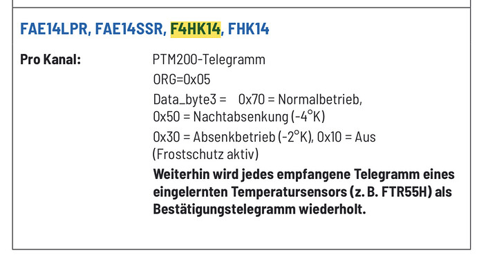

It would be nice if you could implement the FUTH65D for setpoint like via gfvs (and the F4HK14 for checking the state). So it would be possible for me to control my heating via this binding.
Enjoy the holidays and stay healthy,
Best regards Dirk
hi dirk, only two days ago I opened a new thread with the same request:
eltako f4hk14
I thought it could work with the implemented functions and the reason for troubles are my settings… If there is any new variant of the binding I’am open to do testing…

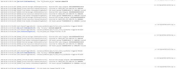

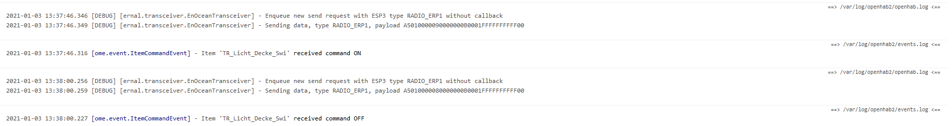

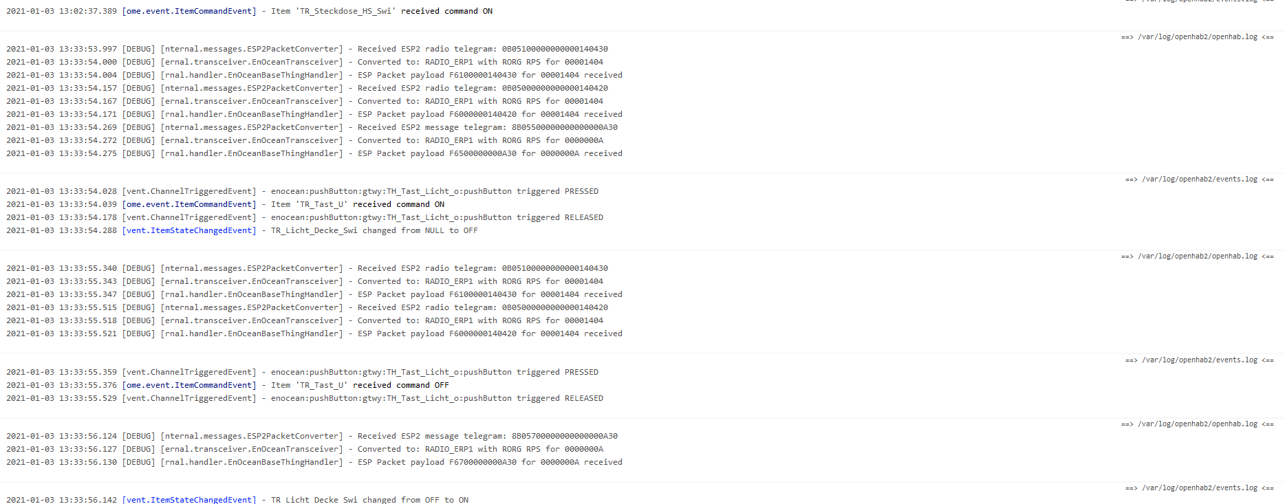

Yet, after installation and reconfiguration to use rfc2217 I’m no longer able to send on the bus.
I can see in the log file that I am receiveing telegrams, yet my predefined telegrams don’t appear on the bus anymore. (I read this by connecting to FAM14 via USB and reading telegrams with winetel. Which has worked just fine in the past, as far as I remember)
My Setup (OPENHAB[NETWORK]<=>RPI3<=> FGW14USB[MODE 6]<=>sensors and actors (FTS14/FUD14/FSB14/FSR14)<=>FAM14[MODE2]<=>PC[WINETEL]
Config:
openhab Server:
enocean.things:
Bridge enocean:bridge:gtwy "EnOcean Gateway" [ path="rfc2217://192.168.100.21:3003",rs485=true,espVersion="ESP2",rs485BaseId="00000001"] {
Thing centralCommand TR_Licht_Decke "TR_Deckenleuchte" @ "DG_Treppenhaus" [enoceanId="0000000A",senderIdOffset=10, sendingEEPId="A5_38_08_01" , receivingEEPId="A5_38_08_01","F6_00_00" , broadcastMessages=true, suppressRepeating=false]
enocean.items:
Switch TR_Licht_Decke_Swi "Treppenhaus Licht" <light> (DG_Treppenhaus,gLicht) {channel="enocean:centralCommand:gtwy:TR_Licht_Decke:generalSwitch", autoupdate="false"}
pi ser2net.conf:
3003:telnet:0:/dev/ttyUSB0:57600 8DATABITS NONE 1STOPBIT banner
but openhab shows the following:
using the manual rocker for switching:
pressing the item in the control panel:
So openhab tells me it is sending the request. but nothing happens.
Am I missing something? The configuration hasn’t changed besides sending commands over rfc2217 instead of usb, and using “official” binding instead of “external” .jar binding.
I can’t remeber if sent telegrams of openhab have been equally long before. They seem too long with the ending “FFFFFFFFFF00”
Is it possible that FGW14 filters the telegrams because they are too long?
Any idea would help.
Thanks in advance

the problem probably is in the area of the ser2net. If I were you, I’d go with a temp minimal OH installation on a fresh additional SD and try to get direct communication with the FGW14USB working there with the current, official binding-version.
If that works, it is confirmed that the problem is with the remote USB/Pi/ser2net
@Aaron2 Since you are also working with central command can you take a look at my Setup which I posted here:
Having some issues with sender id beeing ignored. Maybe since you have a working setup a hint what I am doing wrong would be great!
Best regards!

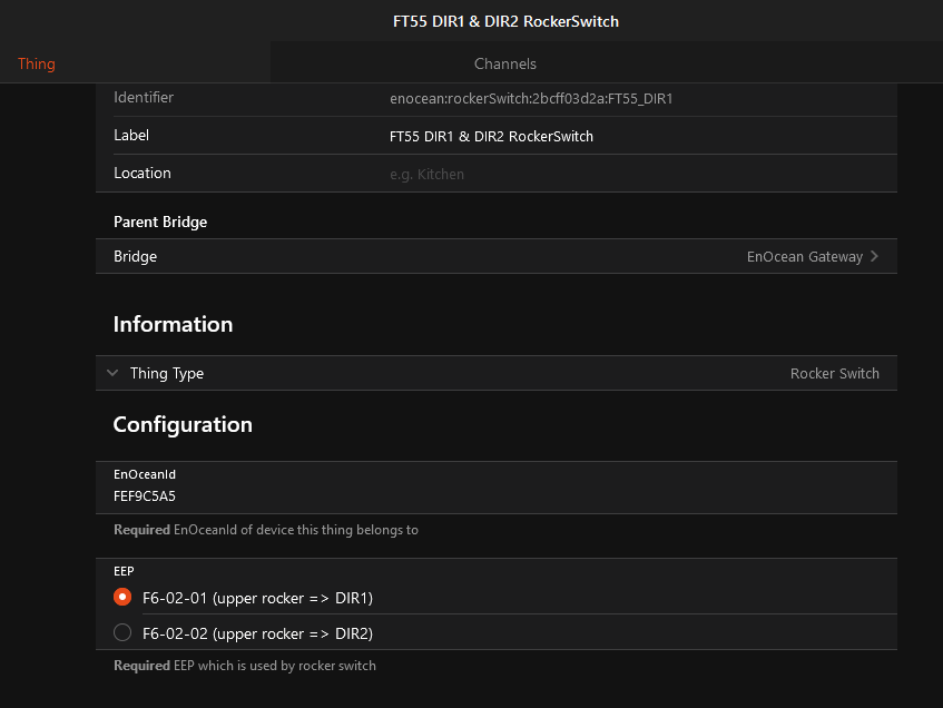

Well, I changed my configuartion a little to achieve the same thing but in a different way. I removed the listener channel on my FMS61NP things. No need for that anymore. I created 1 FT55 RockerSwitch thing.
And I created several rules. To listen at the channels and change the state of my FMS61NP items.
@fruggy83 The only thing which confuses me is the EEP in the thing config:
I thought I need to create 1 thing for each DIR, but during my experiments I find out that I need only 1 thing and I can check which DIR was pressed. I this correct or a bug in the thing implementation?
Anyway, for me it is working :slight_smile:
I’m not fruggy but i’ll try to answer you. to keep it short:
If you choose F6-01-01 the press of the UPPER Butten is interpreted as DIR1 (Lower = DIR2), this is default for the Eltako Rocker Switches
If you coose F6-01-02 the LOWER Button is interpreted as DIR1 (Upper = DIR2)
You only need to create one thing for one physical rocker switch with 4 physical buttons, the left rocker (upper and lower button) is Channel A, the right rocker (upper und lower button) are Channel B.
hope this creates some clarity
@Wuehli This explanation is very helpful, at least for me. Many Thanks!!! I am now using only 1 thing for my physical FT55 and I get the information I want. Thanks for the reply.

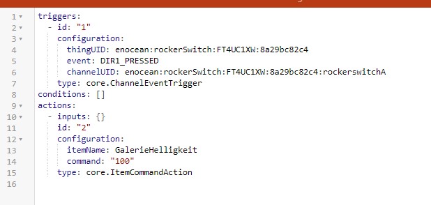

Hi Daniel,
sorry for the delayed reply. Attached some of my rules.
Rules 1&2 react on the trigger sent by an Eltako F6T55B when two of it’s six buttons got pressed. (On that, you can also check my thread https://community.openhab.org/t/eltako-f6t55b-how-to-identify-the-pressed-button on the difficulties I had to get that switch work). Both rules simply turn a light on and off currently.
Rules 3-5 react on the trigger sent by a Peha Enocean switch, and open/close/stop some blinds.
However, what I am trying to do is for example:
if a button is only pressed for a short moment, switch a light on. But when the same button is pressed for a longer time, dimm the light up. I was hoping that this would be somehow supported by the binding, similar to how the Philips Hue binding is supporting the Hue Dimmer Switch (screenshot 6).
other example: when a button is pressed only shortly, start moving blinds up. When same button is pressed longer, start rolling the lamellas only.
I am happy to discuss in more detail, maybe also via confcall, if it helps.
Hi Michael @MaMi,
for the first two rules it should be possible to simply link the channels to your GalerieHelligkeit. However I tried it and since OH3 it is no longer possible to directly link these trigger channels to an item.
BTW @flynux Sorry I missed you post regarding this issue, I will analyse this problem, maybe it is an OH3 issue.
Rules 3-5 cannot be handled by the binding out of the box, as I am not getting these short press/long press messages from eltako rockers. The NodOn soft buttons emit those events short, long and double press.
However it is possible to do it by yourself. You already found a thread about a similar requirement. I already posted some rules there, maybe they give you an idee how to solve your problem. If it is not the case you could pm me and we try to find a solution together.
