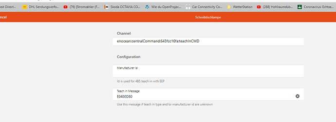

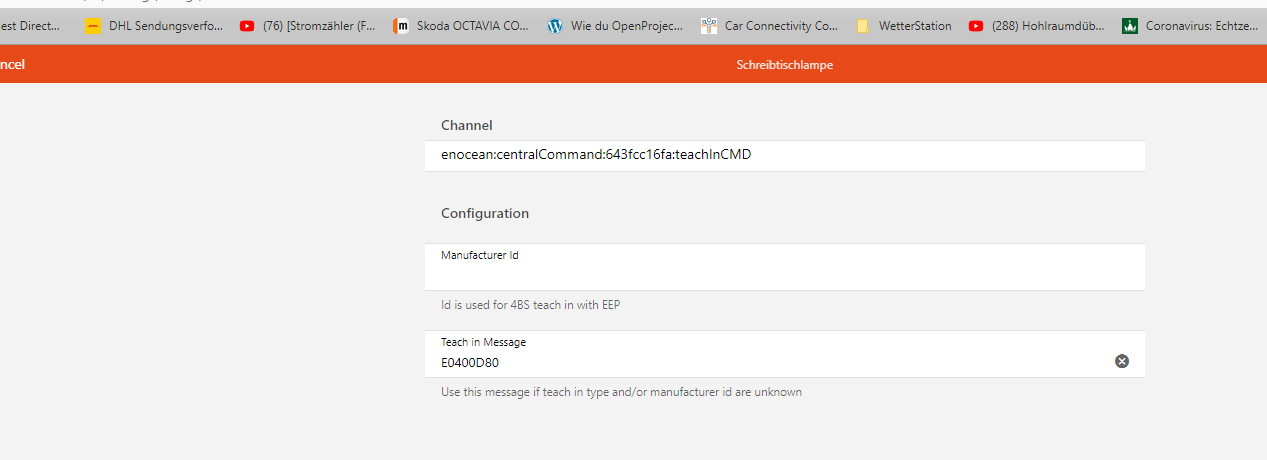

Put first switch in learningmode and sent teachin message:
Enqueue new send request with ESP3 type RADIO_ERP1 without callback
2021-02-03 22:18:31.624 [DEBUG] [ernal.transceiver.EnOceanTransceiver] - Sending data, type RADIO_ERP1, payload A5E0400080000000010F01FFFFFFFFFF00

Put second switch in learningmode and sent teachin message:
2021-02-03 22:23:29.548 [DEBUG] [ernal.transceiver.EnOceanTransceiver] - Enqueue new send request with ESP3 type RADIO_ERP1 without callback
2021-02-03 22:23:29.551 [DEBUG] [ernal.transceiver.EnOceanTransceiver] - Sending data, type RADIO_ERP1, payload A5E0400080000000020F01FFFFFFFFFF00

If you compare the teachin msg it looks good:
After sending the teachin the actuator confirms that learning has been done.

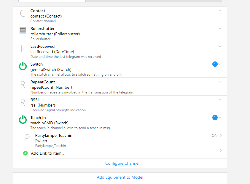

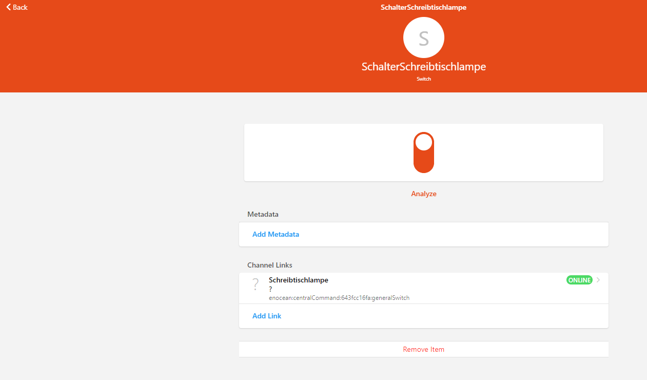

Now I want to switch on my first actuator (SenderId 1) I use the associated Switch Channel which I link to an Item:
