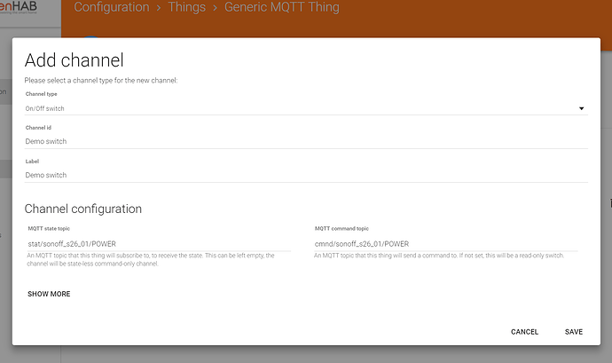

I have the MQTT broker Thing setup and a Thing to represent a sonoff
Auto discovery does not appear to work (Has anyone made this work?)
I’m adding the channels, but would appreciate any assistance on creating correct MQTT State and Command entries

In your case i would add the following
hope it helps
Please use
%prefix%/%topic%/
for full topic
