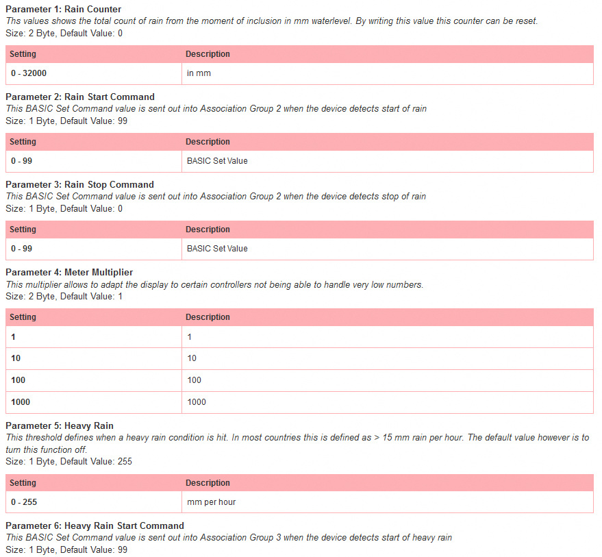

I followed the information, now I have to create an xml file in the device list.
Unfortunately I can not see the green button to do so (right, top) - how can I proceed?
