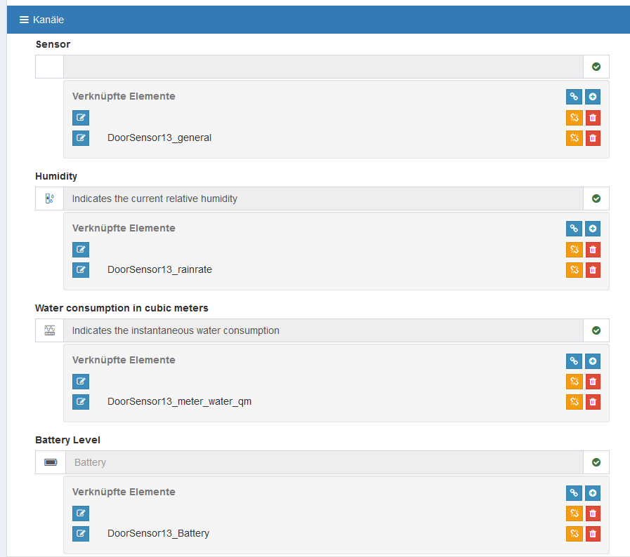

Hi chris,
I’m back from holiday and tried the BASIC channel.
Your last reply:
“I still need to create the BASIC channel for this device as it strangely only uses the BASIC class - but that is special to this device.”
I cannot find this BASIC channel under things/channel in habmin. Did I miss something? Or should I just add it to my z-wave items file like the others?
Existing, showing in channels and working:
Number DoorSensor13_rainrate { channel=“zwave:device:15a7a49f3a6:node13:sensor_rainrate”}
Number DoorSensor13_general { channel=“zwave:device:15a7a49f3a6:node13:sensor_general”}
Number DoorSensor13_meter_water_qm {channel=“zwave:device:15a7a49f3a6:node13:meter_water_cubic_meters”}
Number DoorSensor13_Battery {channel=“zwave:device:15a7a49f3a6:node13:battery-level”}
I got a brand new one now and tested it. Is recognized and working in habmin if you hit the wake up button several times.
It is well known in paperUI too, but no channels were listed only the device itself.
XML if needed
node13.xml (10.8 KB)
Maybe this will help to find xdxoxkx problem.
