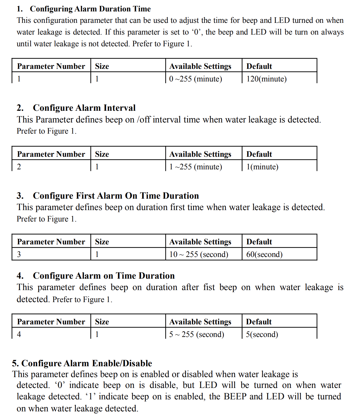

It’s a bit of a mess in the manual (unless I’m mistaken)…
In the same manual, it states -:

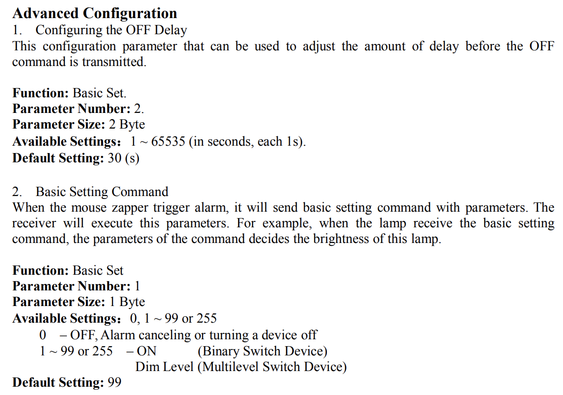

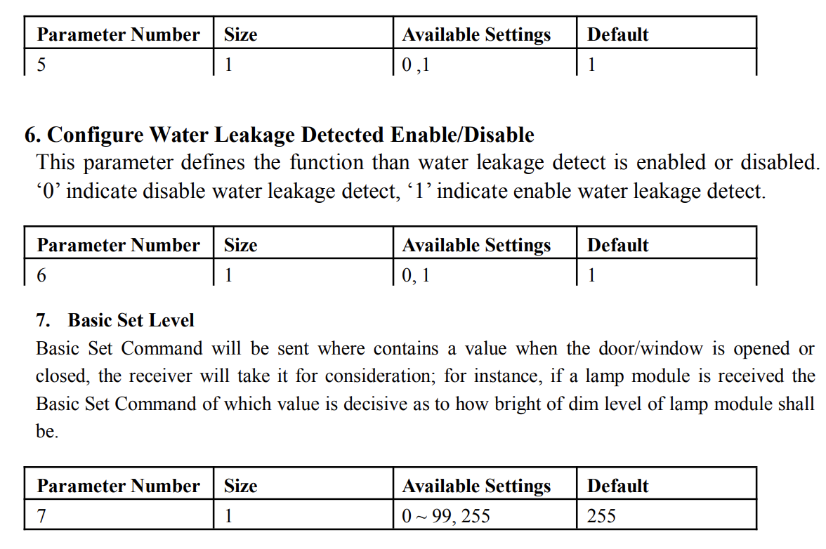

and then a little later -:
[image]
[image]
The database has the first set of two parameters,
I’m not sure what this means as they can’t both be right

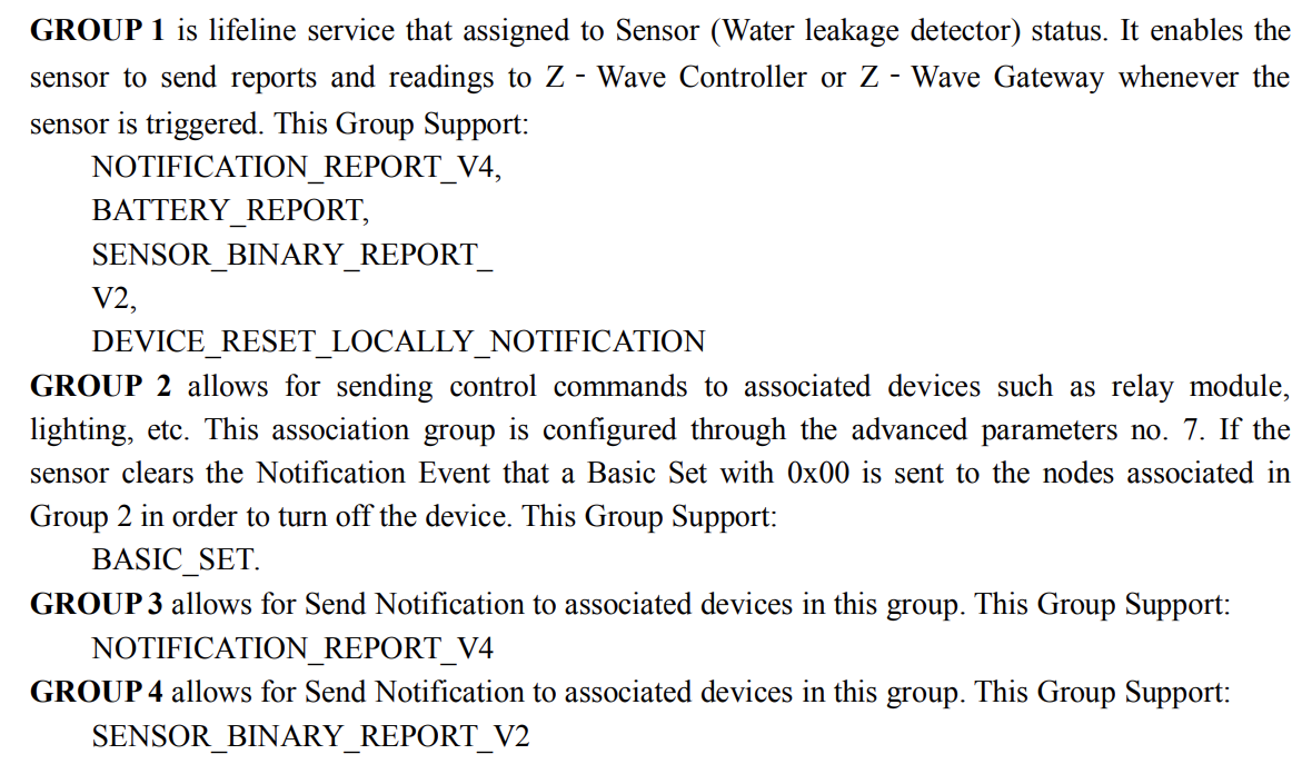

For groups I would use what’s in the manual. It is a requirement in ZWave plus devices for the lifeline to be group 1, so the manual seems to be right in this respect at least -:
