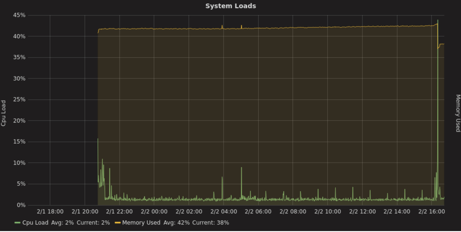

Also the system usage of the CPU and RAM does not change over time:
