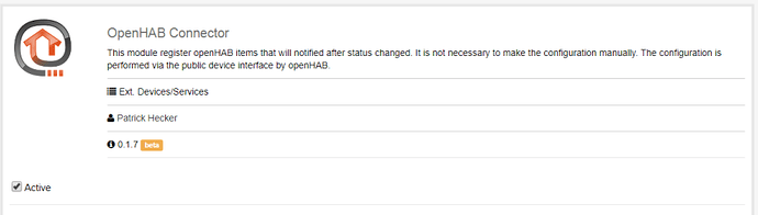

I am running Openhab 2.1.0-1 Stable, Openhab Connector 0.1.7, Z-Wave 1.7.1, Razberry Firmware 2.3.6.
I have just done a total clean install and this issue persists, any help appreciated.

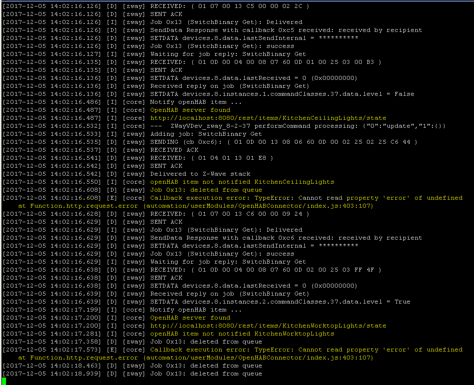

Thanks for the reply, the below seems to be the issue:
Callback execution error: TypeError: Cannot read property ‘error’ of undefined
at Function.http.request.error (automation/userModules/OpenHABConnector/index.js:403:107)
My setup is a RPI2 with the Razberry Board running z-wave. I then have a Ubuntu VM running Openhab. My Openhab is not on localhost per the logs rather http://192.168.80.2:8080, but I presume that is how it communicates?
Any ideas greatly appreciated. I started fresh yesterday with the Ubuntu VM. Considering doing the same with the RPI2 but seems excessive.

I went ahead and installed Openhab2 on the Raspberry Pi that z-wave runs on (localhost). Z-Wave Openhab connector immediately works in this configuration.
What I couldn’t get to work was have the Openhab Connector work correctly with a remote Openhab2 instance
