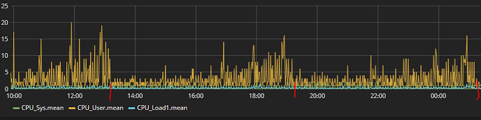

I have similar problems with Z-Way and Openhab bindings. Upon examination, i found the CPU increases the load until the openhab becomes slow and at least stops after a number of hours.
The more Z-wave units in network - the faster the CPU load increase.
I’ve solved the problem of a “work-around” using 1.x file for z-way server configuration in (things/zway.things).
Then i overwrite zway.things file every 6 hours with crontab. The OpenHab will update all things and CPU goes down again. (Se the red mark in picture)
Something seems to be buffed in openhab but I have not managed to find what it depends on.
