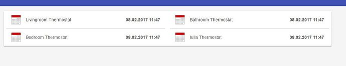

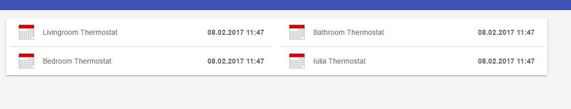

Getting back to the “last seen” timestamp…

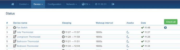

Where do you get this “last seen” info from? I’m interested in the “last seen” timestamp as the time when the device last communicated with the z-way controller.
It seems that that is not the case…
Here are 2 screenshots:
The second image comes from the Z-Way Expert-UI and you can see in clear the time when the device connected to the controller.
In the screenshot from my sitemap, there is another timestamp.
Maybe this is from the last time the binding scanned the z-way-server for devices?
I’ve use the update time from the virtual device (http://YOUR_IP/ZAutomation/api/v1/devices/DEVICE_ID).
Timestamp from ExpertUI is much better, I will change this for physical devices, and keep the existing timestamp for “real” virtual devices.
Can you confirm that it is the value I can load with: http://YOUR_ID/ZWaveAPI/Run/devices[NODE_ID].data.lastReceived.updateTime
Yes, the API link seems OK.
