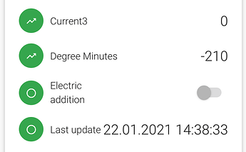

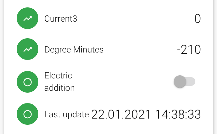

”Last update” is showing GMT+0 time and not my local time. Can this be changed somewhere? Other bindings/things are showing local time.
Hmm, GMT+0 is what the API returns, and when put into a DateTimeType i think it should handle timezone conversion automatically (it’s internally stored as a ZonedDateTime) but not sure how to tell OH in what timezone to display. But I also see that DateTime items from other bindings are displayed differently, will check how they do it.
The timezone issue was an easy fix, uploaded a new build. I also increased the trace logging to make it easier to debug the other issues. Now you should be able to follow the requests from when they’re put in the queue to when the channels are updated.

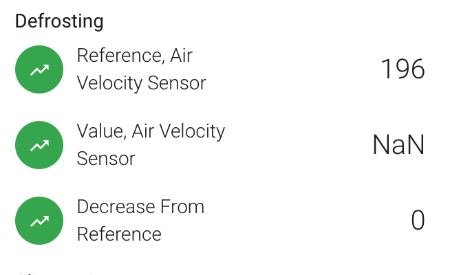

Air velocity sensor is not returning any value (it does on the nibeuplink.com), only reference value is shown:
Is this something that you are observing as well?
Can you check the state of the item in some other way? PaperUI doesn’t display the raw state of the Item, I would guess it is either NULL or UNDEF for some reason. What does your events.log show for this Item?
It’s “NULL”
events.log has a lot of entries for reference air velocity, but not so many for air velocity:
2021-01-15 16:48:12.785 [ome.event.ItemUpdatedEvent] - Item 'NibeF750RESTAPI_Defrosting_ValueAirVelocitySensor' has been updated.
2021-01-15 17:41:40.655 [vent.ItemStateChangedEvent] - NibeF750RESTAPI_Defrosting_ReferenceAirVelocitySensor changed from 226.9 to UNDEF
2021-01-15 17:47:40.766 [vent.ItemStateChangedEvent] - NibeF750RESTAPI_Defrosting_ReferenceAirVelocitySensor changed from UNDEF to 228.1
(for some reason the most recent entries were from 15th, although the file itself had a modification time stamp of today)
Is it just the Nibe REST binding that doesn’t have any newer log entries or are there none at all since the 15th? In the former case, try to restart the binding (bundle:restart org.openhab.binding.nibeuplinkrest) or openHAB. If there are no entries at all I’m afraid you might have bigger problems (possibly a failing SD-card if you’re using a Raspberry Pi), which you should look into.
