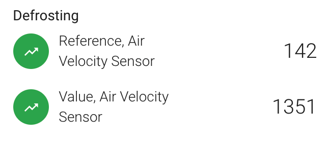

@pacive, thanks again for the excellent Nibe uplink API binding! I’ve used it only a couple of hours with F750, but would have some suggestions for improvement:
Here, the actual air velocity is incorrect, should be divided by 10. Also, for the temperature values, is it possible to add a unit (e.g. °C)?

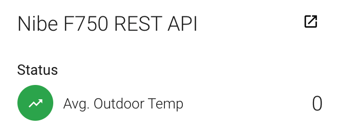

About rounding, it would be nice if values had one decimal or at least if it would be configurable.

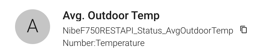

What is your Item definition? Is it defined as Temperature ?
Yes
That’s strange, might have to do with the auto discovery of the channels, will look into it. In the meantime, it’s possible to change the scaling factor manually on the channel (click the pencil icon beside the channel in the thing view).

I haven’t been able to test the amperage values, since the sensors are not installed in my system, but will have a look at how the channels are created and updated if all of them report the same value. Also, there shouldn’t be any rounding done, but the problem is that the API reports all values as integers that have to be divided by 10 or 100, or not at all. E.g. a temperature of 21.3 is reported as 213. When the channels are created the binding tries to deduce what the scaling factor should be, but it can miss sometimes, that’s why it can be overridden.

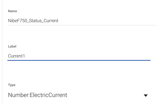

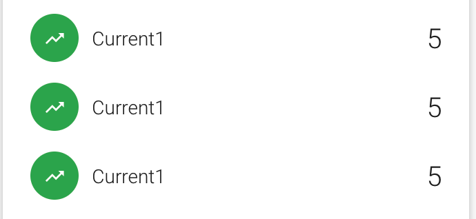

But the problem is that UI links these to the same value:
When I link one channel, all three are “activated”. Should there be a unique name for all three channels? E.g. NibeF750_Status_Current1, NibeF750_Status_Current2 …?

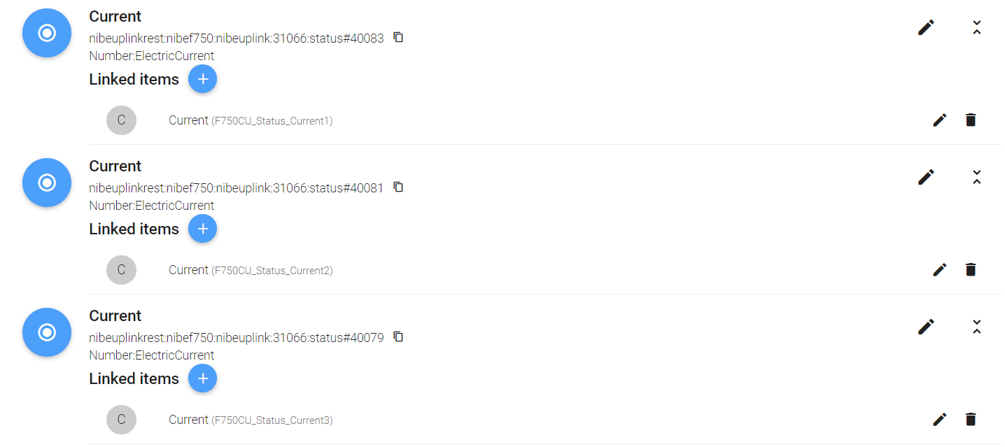

It seems like you have the same Item linked to all three channels (There are three Current1 in the list). The Name of the Items need to be unique, so creating different Items like you said needs to be done. If you look at the channel list it should look something like this:
Where the item name is the one in the parenthesis, and this need to be be different for all three channels.
As for the rounding you mentioned earlier this is done by paperUI in the Control page, the value stored in the Item itself should be exact. If you use basicUI or habpanel the correct value should be displayed.
Okay, now it works as expected. Somehow I thought only label was editable…
