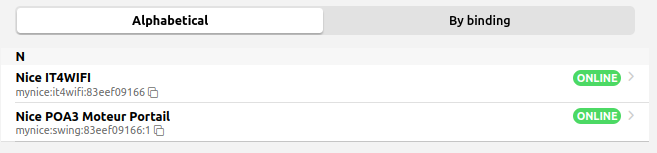

I successfully discovered my IT4WIFI, created user, grant permissions on app. Now Device have status ā€œOnlineā€. But it have no any channels :slightly_smiling_face: What now I should to do?
There are no channels held by the IT4Wifi bridge. Once created it ā€˜should’ auto discover a thing corresponding to your gate (that holds channels).
Something like that :

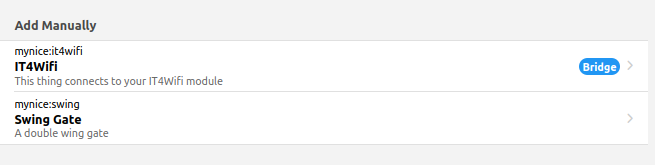

If it’s not the case, you can try adding it manually :
Only swing gates supported? I have a sliding gate, with Nice RB600 motor.
Yes, only swing currently as it’s the only one I have :slight_smile:
