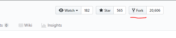

Fork and Clone the Nightscout Repo
The built in update mechanism depends on comparing your fork to the main Nightscout repo on GitHub. So if you want the ability to determine when it is time to upgrade automatically you must create a GitHub account, if you don’t have one already. Plus, this will let you contribute to OH. :wink:
Log into GitHub and navigate to the main nightscout repo.
Now fork the repo.
This should open you to a https://github.com/<your github username>/cgm-remote-monitor page which is a complete copy of everything in the “official” repo.
