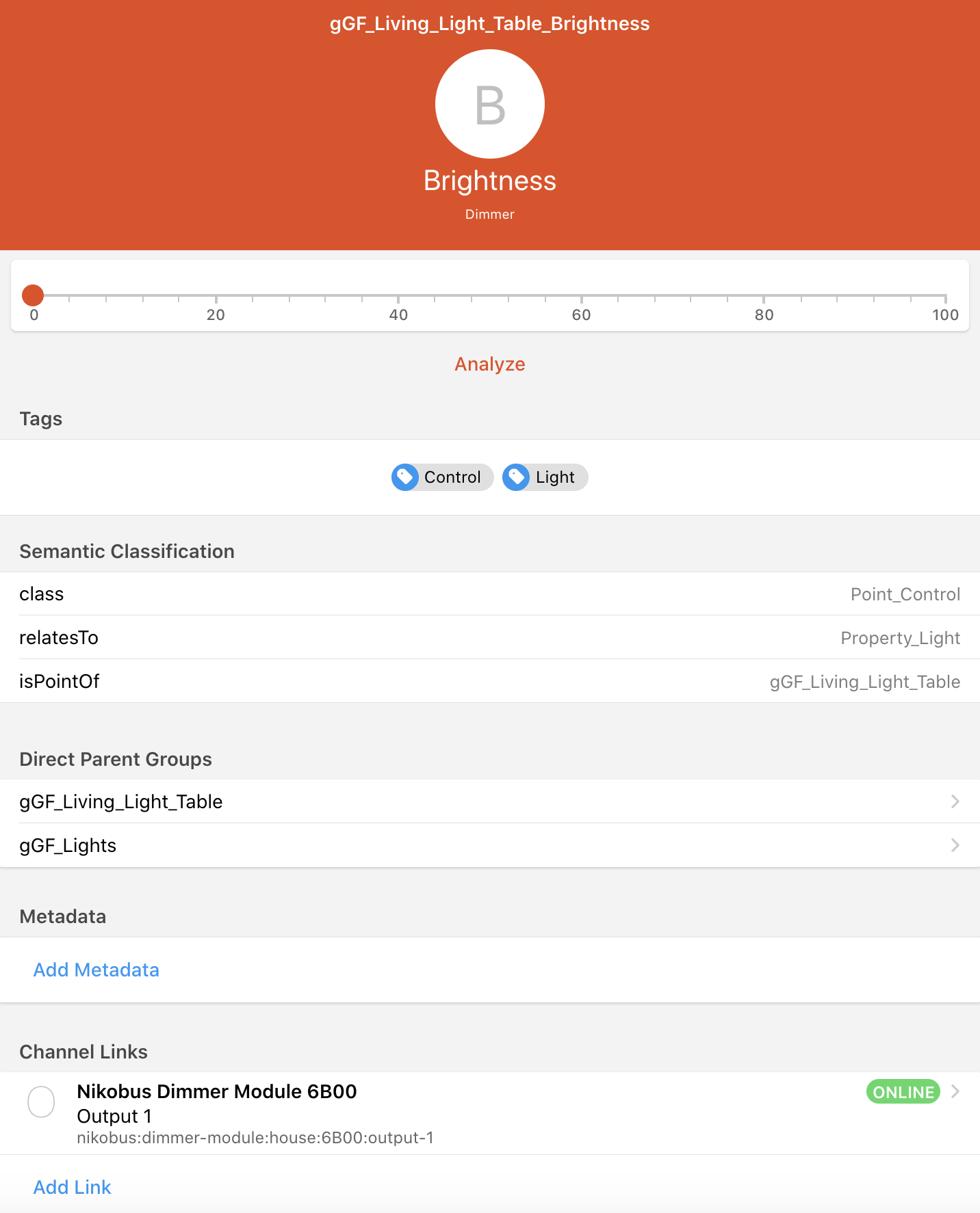

There is nothing special, simplest case would be something like

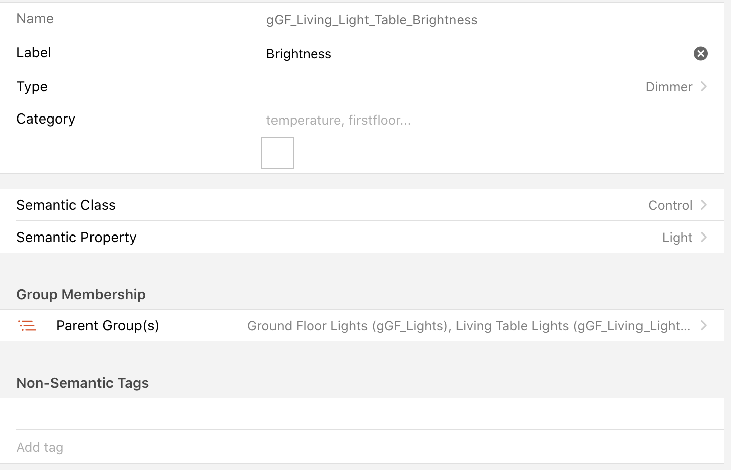

- component: oh-slider
    item: gGF_Living_Light_Table_Brightness
where gGF_Living_Light_Table_Brightness is linked to respective dimmer module’s output channel
When you setup an item and set its type as Dimmer, OH also knows to use slider in order to control it and there is nothing you need to do (additionally) - it just works. Would recommend you build up the semantic model

Semantic model won’t help you in this regard. If you want your LEDs to be in sync, then you cannot link to dimmer’s output channel, as already explained, since this communicates directly with the module, so your buttons (and LEDs) have no idea what is going on.
Simulated button press (when you send the ON command to it) is behaving exactly the same as if you would briefly tap a physical Nikobus push button. So you can turn your lights on and off but cannot dim them. If you want to be able to do so too, you will need to write a rule that will send ON commands in i.e. 100ms intervals while you keep pushing the button on UI.
