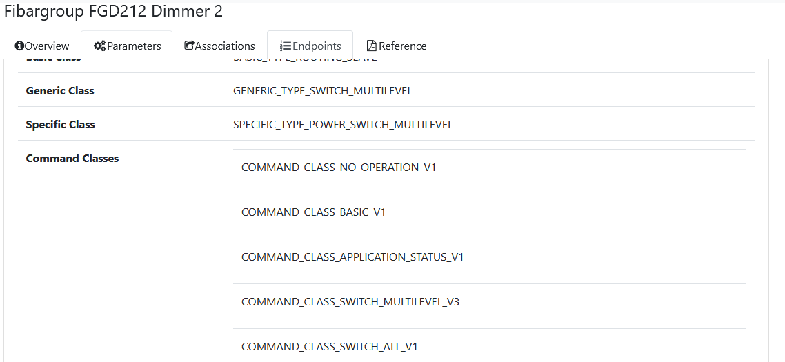

The endpoints are different. IMHO a SWITCH_MULTILEVEL_REPORT should come from endpoint 1 (or 2), but never from endpoint 0. A SWITCH_MULTILEVEL_REPORT from endpoint 0 doesn’t make sense to me and for endpoint 0 no channel is defined in the Z-Wave database:
So - if @chis doesn’t disagree
- I would conclude that OH/Z-Wave binding is working as designed and there is a problem with your device.
