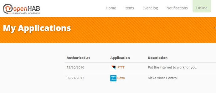

You forgot to post the most important picture:
So make sure you have granted access for the skill to the cloud connector.

Sorry, my fault, overlooked you are using it through myopenhab.
