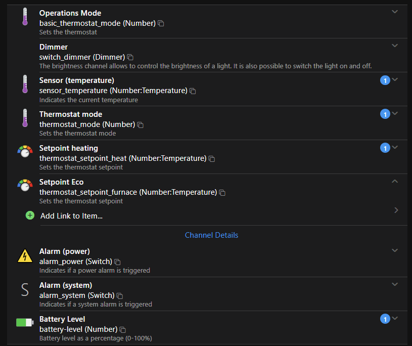

I have recently bought new Comet Z-Wave Radiator controllers.
I think they have a new firmware because the old one I have has less channels to be linked.

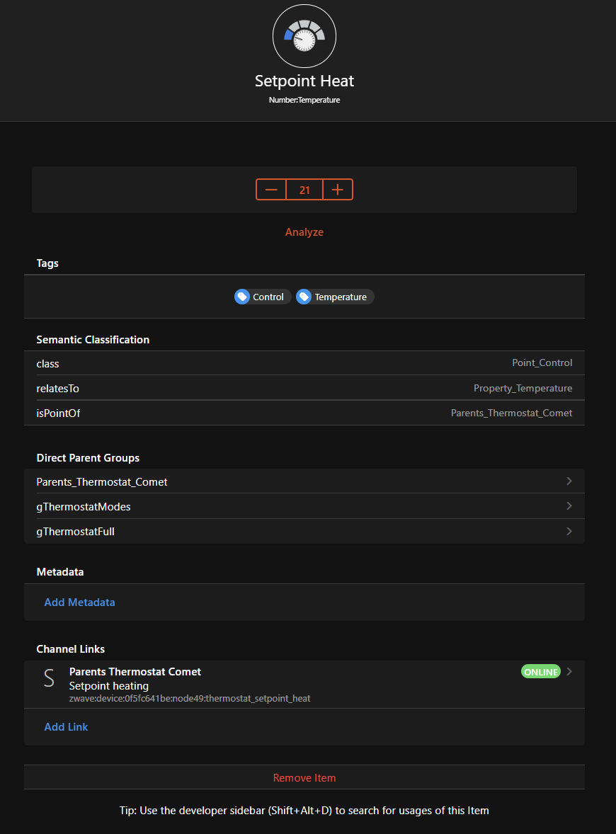

Unexpectedly when i want to send the message to change the Set Heating value. I receive this error:
I checked all configuration and compared with the old controller.
I removed the temperature dimension in the settings and error does not appear. But sending the message to the controller does not change the value on the controller itself - no reaction on temp. set.
looking in the log files i see the message (last three lines):
Received commands datatype DecimalType couldn't be converted to channels datatype QuantityType
Any Ideas on that? It seems the value being sent has a wrong type.

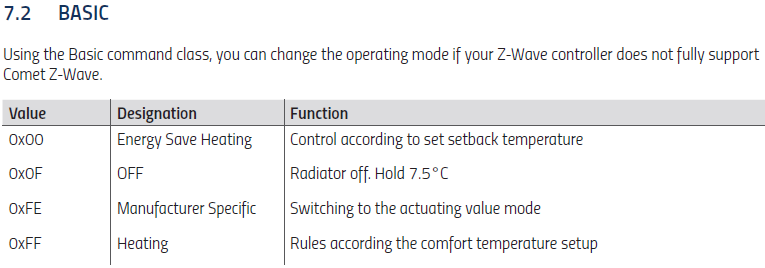

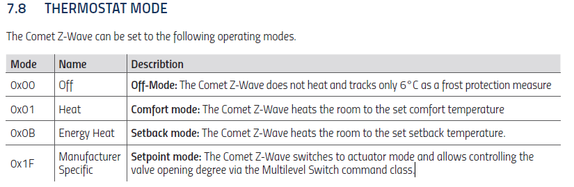

I’d check the channels description against the linked items. Mode is decimal (probably 0 off or 1 heat) and setpoint needs to be temperature. Maybe with the extra channels there is a mismatch. This is also in the debug near the middle after to command to set the Mode at 1 (this seems an odd command). (the log is filtered so I can’t analyze the byte message that was received).

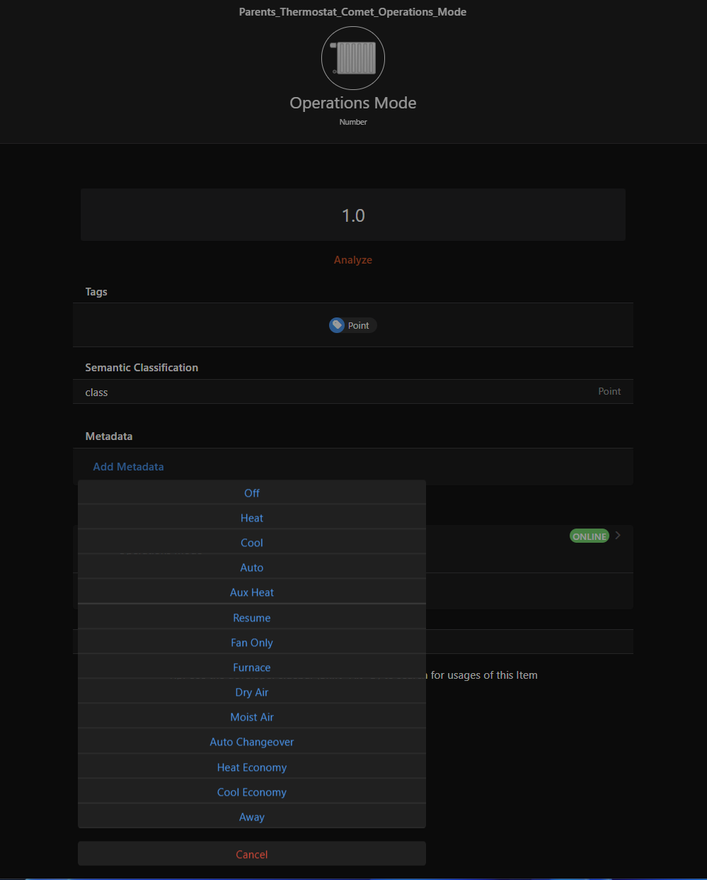

Thank you Bob,
Indeed there are some new channels I see first time:
I do not think so, 1 i a default value for Heat mode. 0=OFF 11=Economy Heat, 15=Full Power (Valve fully open). I was expecting the same in the new controller. Let me check your suggestion with eco setpoint.
I am just wondering why the heck I have Dimmer channel for the heat controller?
I did connect other channels and try to operate with them.
  1. I am surprised about Dimming Channel in this Thing
  2. Setpoint Eco has following options (???):
  3. Activating Heat mode and changing the set temperature does not influence controller change. There is still the same set temp. displayed. And vice versa. Changing the temperature directly on the controller does not update Setpoint Heat value.
Is there something with the OH configuration files?

Yes. I fixed what I believe was the problem and edited the XML to what it will look like when approved and in the next ZW binding snapshot. The last ZW DB update was 3 weeks ago, so there should be another soon-ish. Because the developer is very busy with his real job, I have been offering folks the manual binding update option. I didn’t want you to freeze :wink:, because sometimes the wait could be weeks. The location for your device is here
Other notes
  1. The dimmer might have to do with the brightness of the device light (not to keep you up at night?)
  2. I was talking about the Setpoint Eco, your picture is the Operations Mode channel. I’m not sure about that. I think it is a copy of the Thermostat mode
  3. I don’t have these things, but have a furnace, so for me the Mode is 1 all winter long. Heat goes on when the sensor temperature is below the setpoint and off when the setpoint is reached. Sounds like you have to turn it on first when you want heat. No worries.
The problem I think I fixed was that the Setpoint heating referenced a Setpoint Type=Heat, it needs to be Setpoint Type=Heating. The setpoint Eco Type=Furnace, so that was legit, so I thought it could be a workaround. I did however change it Type= Econ_Heat because I think it needs to match option 11

Set point Heat 21°C and later to 22°C - no reaction from the controller
2024-03-10 18:07:37.111 [DEBUG] [ding.zwave.handler.ZWaveThingHandler] - NODE 49: Command received zwave:device:0f5fc641be:node49:thermostat_setpoint_heat --> 21 °C [QuantityType]
2024-03-10 18:07:41.571 [DEBUG] [ding.zwave.handler.ZWaveThingHandler] - NODE 49: Command received zwave:device:0f5fc641be:node49:thermostat_setpoint_heat --> 22 °C [QuantityType]

To be honest. I made an update to 4.2.2 and I still can not properly control the thermostat. There are too many features and options to control. Too many modes. For me it is still not working properly.
I think the channel “Operations Mode” does not make sense for this device and should be removed (I don’t know if there was a mix-up with another AC device).
As far as I can see, The options “Off”,“Heat”,“Economy Heat” and “Full Power” of the channel “Thermostat mode” are the only one that are documented and are useful.
I still have the problem that the “Setpoint Eco” actually also sets the Setpoint heating temperature (i.e. the on selected in “Heat” mode). It should set the “Economy Heat” temperature.
I guess something went wrong with the device config but that was what the zwave database proposed after importing the XML.
I don’t know enought to be able to narrow the problem down to the device configuration or binding bugs.

Anyway, it doesn’t make a difference.
Setpount econupdates the heat temperature, i.e the target temperature in heat mode.
What does your operations mode look like? Is it linked to a switch or number? Try setting that to OFF or 0 while changing the eco setpoint. Also have thermostat mode on eco_heat.
FWIW- what I’m thinking from the manual is that the BASIC channel is a duplicate of the thermostat mode, except that the numbers are different.
So to use the econ setpoint the Basic needs to be 0 and the Mode needs to be 11. I’m not sure what overrules. Also from the binding the Basic is an ON (0xFF)/OFF(Ox00), so am not sure what is happening there. PS Don’t have the device, just an idea to test
I’ve tried all combinations. Operations Mode Off and thermostat Mode Eco (11),both off and both Eco.
Same result, changing the setpoint eco changes the setpoint heat and resets to 16 degrees.
When I switch to Heat, the temperatur is set to the setpoint heat temperature, when switching back it’s reset to the default of 16 degrees.
I don’t understand why there are two channels when they cannot set individually.
Well that was my best guess. I did delete the Operations Mode for the next ZW DB update because it is confusing.
You could probably work around this with a rule(s). I use time of day (or vacation, work) to change the setpoint. According to the manual both eco and heat have the same range.
Edit: also added the Manual option (0x1F) which should allow the dimmer to control the valve % and changed the power alarm to a battery alarm so it will work.
EDIT2: You could try overwriting this modified file to your Zwave binding, but I’m not optimistic since the test didn’t work.
EDIT: Readded a basic switch to maybe allow for Eco or Heat based on the manual options.
