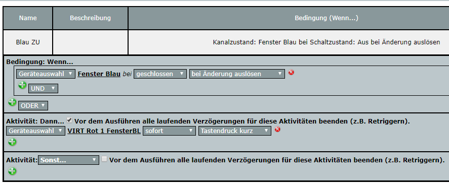

A program in Homematic is sending a “Short press” at the virtual remote, as soon as an input of the FCI6 is activated. The remote’s channel is then visible in openHAB.
Program to forward a state change of an HmIP-FCI6 channel via a virtual remote control to OH:
(sorry, my WebGUI is set to german, but I believe one can guess whats meant)

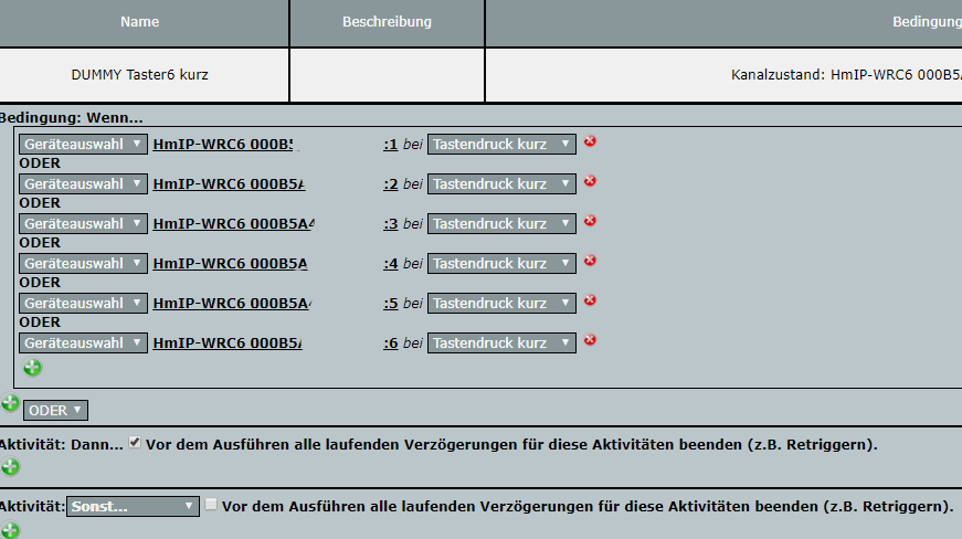

I was also facing similar trouble with a HmIP-WRC6 (six channel push button device). Here I implemented a script in RaspberryMatic that actually has no output, but only all the inputs from the device. It seems, that each of these channels has to be used at least once in an HM program. Only then it is forwarded to openHAB.
Program to force sending key presses to OH (for HmIP-WRC6):

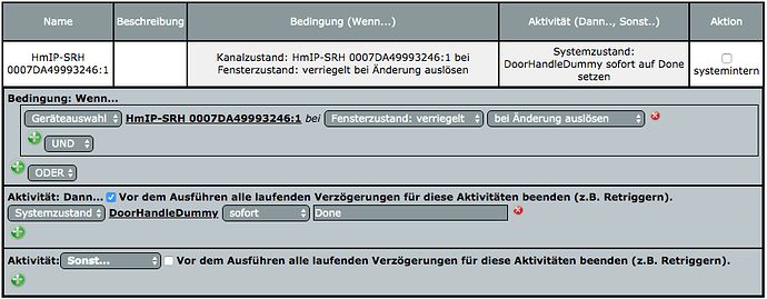

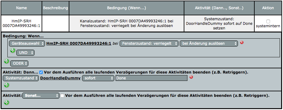

In the meantime I found the solution. It was my fault. :wink:
The item configuration was declared as a Contact Type, which simply does not match the Channels type of String. So sorry for the confusion: The HmIP-SRH works perfect, even without a program as shown about.
