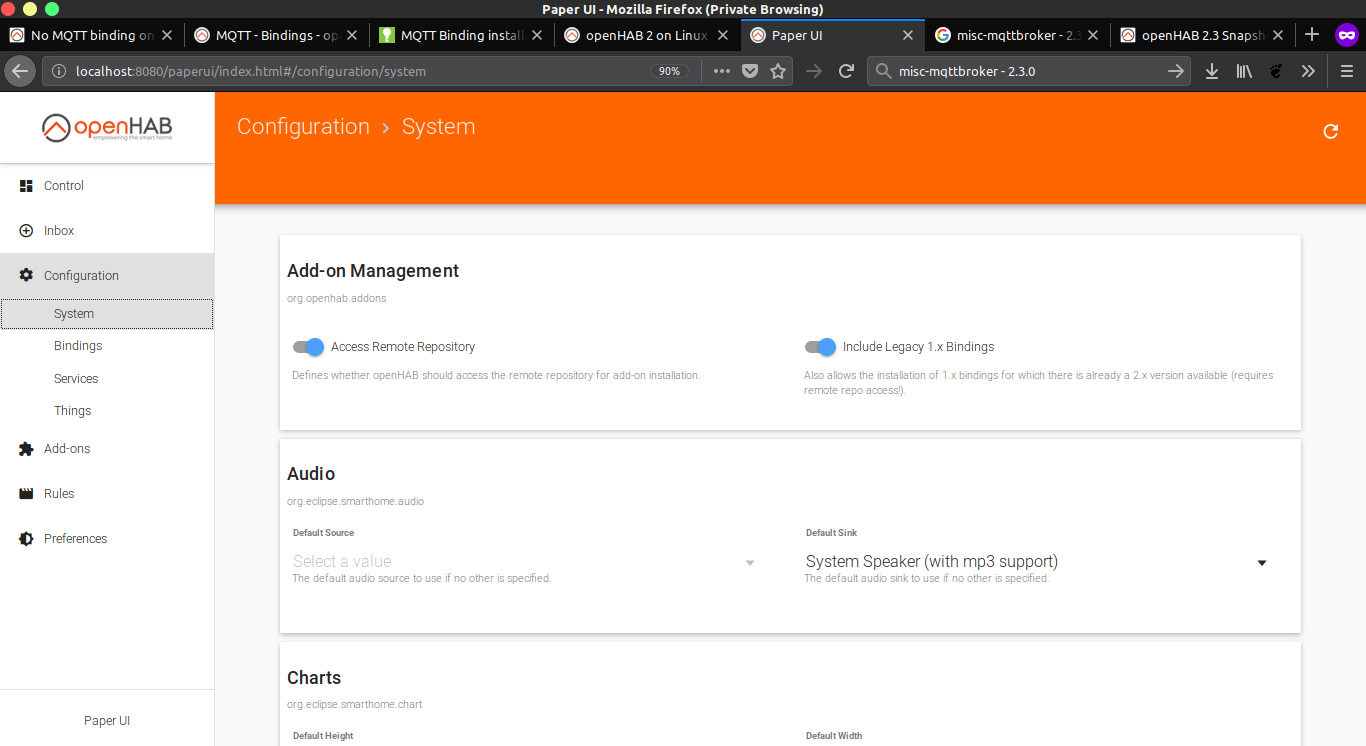

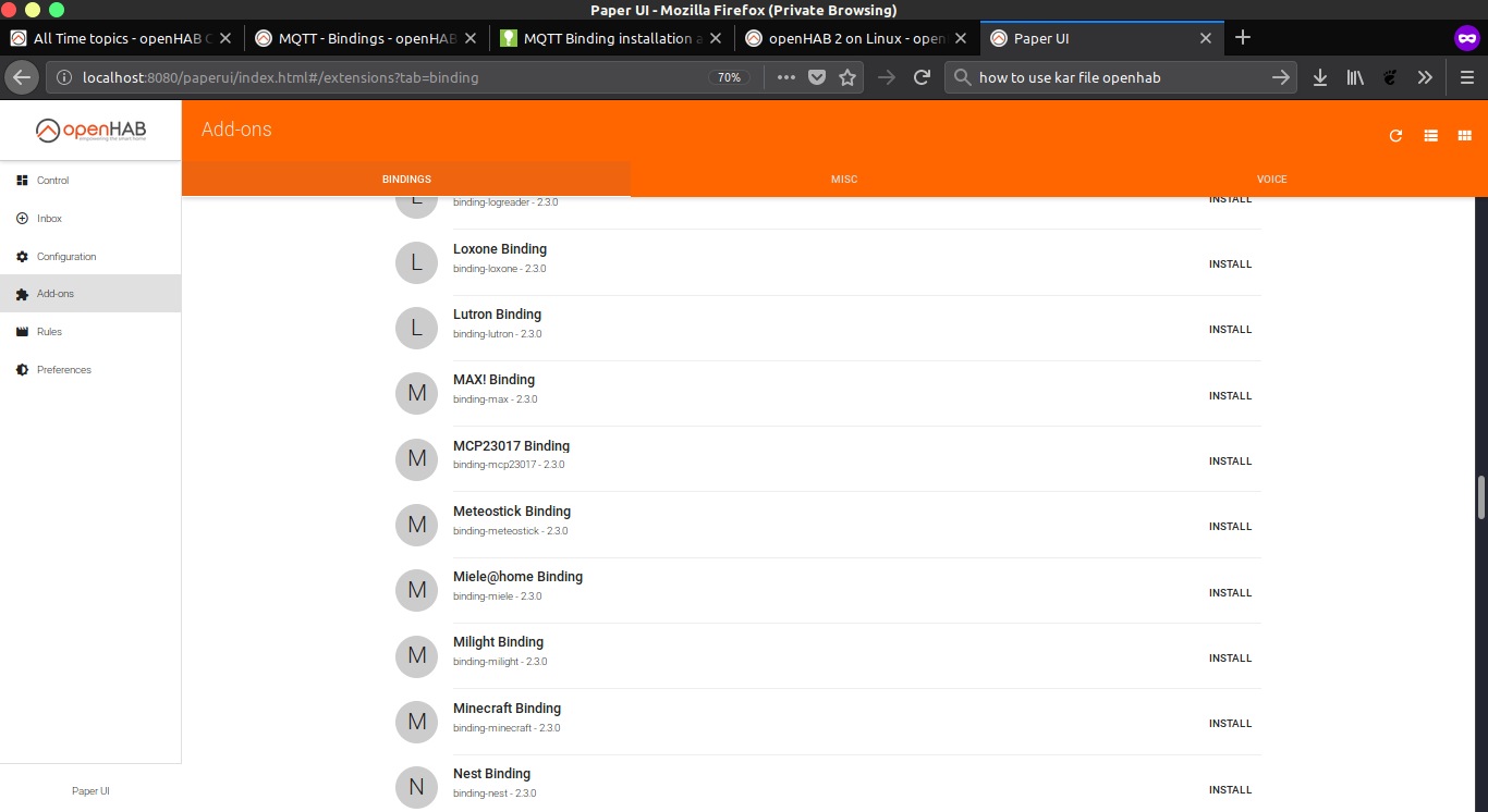

Below image is the screen shot of OpenHAB paper UI (could’t find MQTT binding)
Screenshot%20from%202018-08-27%2022-46-04
I already enabled the legacy add-on option in the Configuration > System > Add-on Management
Am I doing any thing wrong or missing any step?
Turn on “Access Remote Repository” in Configuration > System
That option is also enable
Unrelated: I’d turn off the Include Legacy 1.x Bindings option to avoid confusion
Then the next step is to press the refresh button in top right corner of the Bindings tab to make sure it’s pulling a fresh list. I noticed that sometimes the menu in OH don’t refresh correctly and clicking that helps it refresh.

initially it was turned off.

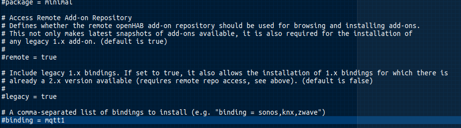

If that still does not work, you might want to try it on CLI, i.e. edit /etc/openhab2/services/addons.cfg.
You would need to list mqtt1 as part of the bindings line.
No you don’t That option is confusing. That’s for bindings for which there is a 2.0 Binding available to still show the 1.x binding.
There’s no 2.x binding for MQTT. So it will by Default still show up.

In the another post, it says that legacy bindings only available when package is set to expert mode, so, I will try that and let you know…
I was using standard package, changing package to Expert mode solved the issue (Without changing any thing in Configuration > System).

I did not see MQTT bindings because my package was set on “minimal” mode. Changed to “standard”, rebooted and the “binding-mqtt1 - 1.12.0” package was shown. Also “Include Legacy 1.x Bindings” was on.
